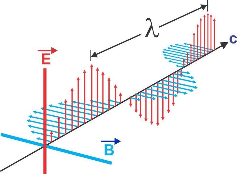

PeterDonis said:
I'm not sure what this even means
Familiar with this picture?
Diagram of a plane electromagnetic wave travelling along the c axis: red E field vectors oscillate vertically and blue B field vectors oscillate horizontally, both perpendicular to the direction of travel, with wavelength marked as lambda.
Does this complex wave explain a single particle? Say, a red photon or a gamma ray photon?
However I assume you have already answered this with a no. It arises from a number of photons. I don't know what QED says about EM waves but I just ordered a copy of Feynman's book, QED.
I've seen pictures like it. Where did you get it from and what do you think it describes?
Why do you think it's a complex wave? The E and B fields are real.
Every time I've seen a picture like this, it's describing a classical EM wave.
No, it arises from a classical EM wave.
An image search for EM wave. It even shows up when searching "photon."
If this is what a single photon is like, a particle with no size, then it seems rather complex and of size. A single water molecule isn't a water wave.
And this EM wave is what? A single photon? Many photons?
Which certainly does not make this a reliable way of finding out what "photon" means. You need to be looking at textbooks or peer-reviewed papers, not trying to learn science from random image searches.
It isn't. I already told you what the picture is describing: a classical EM wave. A classical EM wave is not a photon; I've already answered that too.
No and no. See above. A classical EM wave is a classical EM wave. It's what you get when you solve Maxwell's Equations, the equations of classical electrodynamics, for the case of no sources (zero charge and current density).
Actually I have read science articles explaining photons as electromagnetic waves. I should've bookmarked them and linked them here, but this is why I asked such a question.
Fair enough. This is all I asked if an EM wave is a photon. I got my answer.

A plane electromagnetic wave may be understood as the classical limit of a "coherent state" of photons, the latter of which is made up of an indefinite number of photons. In particular, the number of photons contained in a coherent state obeys some probability distribution, but in the classical limit that distribution is peaked at some very large number with very little spread around it, so one can characterize the state by N, the average number of photons in the state.
Just like with the number of photons, the electric and magnetic fields are also uncertain, taking values from some probability distribution. However, if you take the expectation value of the electric and magnetic fields, you find that they are also very sharply peak about some mean values, and that mean value evolves in space and time just as in the picture you've posted. This evolution can be represented mathematically as
<|\mathbf{E}(x,t)|> = \sqrt{\frac{N \hbar}{\omega \kappa}} \cos(\omega t - kx)
where [itex]\omega[/itex] is the frequency of the photon, [itex]k = \omega/c[/itex], [itex]\hbar[/itex] is the reduced Planck's constant, and [itex]\kappa[/itex] stands for some mess of constants (depending on your choice of unit system) which I will not bother to figure out. I will also point out that the average energy of this state is given by the usual Planck formula formula
<E> = N \hbar \omega.
We now take the classical limit, which clearly requires [itex]\hbar \rightarrow 0[/itex]. However, doing so naively results in the amplitude and energy of the wave going to zero. Instead, we must take the limit
\hbar \rightarrow 0, \quad N \rightarrow \infty, \quad N \hbar \rightarrow \mathrm{constant}.
The constant can be any real number. Therefore, in the classical limit we take the number of photons in the wave to be infinite. (This is as close as your question comes to having an answer.) With such a limit, we also see that energy is proportional to the square of the amplitude of the electric field. The constant which appeared is a tunable parameter in the classical theory (it just corresponds to boundary conditions when you solve Maxwell's equations).
Finally, let me stress that a single photon of a given frequency looks nothing like anything you've seen in classical physics. In particular, the electric and magnetic fields of a single photon are constant in time, and they are (as always in quantum electrodynamics) described by a probability distribution. The average fields of a photon are actually zero, but there is some finite spread in probabilities around zero. This is not something that looks like classical electromagnetism.
