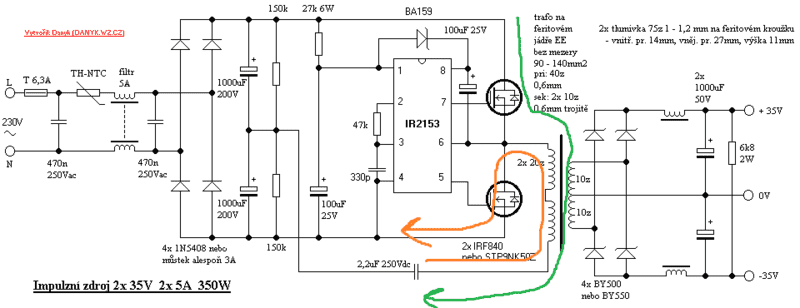

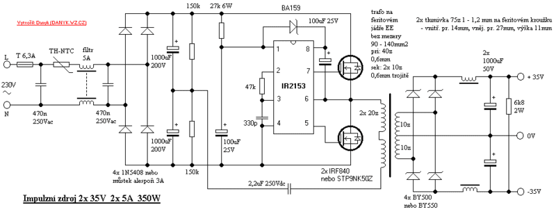

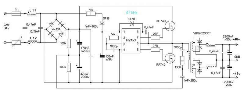

Well basically , as I said earlier I wanted to make a both polarity and amplitude varying voltage source that could be fed into the transformer pirmary in order to then convert it to whatever voltage /current needed + the isolation part between primary and secondary that the transformer gives.
The transformer is the long known part and it works just okay.The thing is to make it work with dc power source.We have smps and all kinds of other topologies etc.
I was just thinking of a easier way to do it, not saying it possible just thinking, learning in the process etc.
So we concluded after all these two thread talk that a capacitor in a circuit being in series with the pirmary could pump charges back and forth through the pirmary if it's capacity could be altered , the problem here ofcourse is how does one do that , not speaking about the rotors or any mechanical stuff but in a solid satte way.
A mechanical analogy here , when I was younger i remeber an abandoned building which had elevator shafts on the top floor in the elevator engine room , there were these concrete pads on which the electric motors that pulled the cables were located, these pads stand on 4 springs , I stood on the pads and jumped and after a few jumps I could make them oscillate, now if I would just stand there doing nothing the pad would also stand still, DC is like that it just exerts a constant pressure so to speak but nothing happens , now imagine these pads and the weight on them , if one could alter the stifness of the springs while I stand there , the pads would start to oscillate just as if I would be jumping on them , only in this case I wouldn't be jumping rather standing still but altering the stifness of the springs would make the pad go lower and then higher again and so it would gain inertai and try to reach it's resonant frequency probably , which would also be largely dependent on the rate at which one altered the springs.
In my capacitor transformer case it is similar , the dc source applies a constant voltage to the circuit but altering the capacitors capacitance with the help of the dielectric one could make this oscillation in the cirucit.
Im not sure not an expert on materials science but maybe there is a nanotechnology way to make a dielectric whose dielectric constant could be altered in a large enough amplitude to cause noticable changes in the capacitance of a capacitor, ofcourse that also begs the question by what method the dielectric could be made to change , an applied voltage or a field or whatnot.
Speaking about dielectrics I have been looking and what happens to their inner workings when they are in a capacitor and the PD is applied across the plates to charge it up.Diagrams show that polarization happens inside the dielectric as molecules polarize themselves to allign according to the applied field from the plates , what would ahppen if one could alter this alignment process inside the dielectric material ? how would that affect the field between the plates, now we know that the dielectric itself affects the field between the plates , it decreases it's strength which is the reason more charge has to flow to the plates to set equilibrum condition.

Ok the idea itself aside , I want to ask some question to clear some misunderstandings.
Simon or Sophie one of you argued here several posts back that with a cpacitor nothing can happen because the attached battery cannot do any work on the system because charges cannot flow directly as capacitor blovks charge flow.But if one makes a changing electric field due to the discharge and charge of a capacitor in series wtih a trasnformer pirmary does that also cannot do work on the transformer in the way of induction , because as I know a varying electric field produces a varying magnetic field and that again induces an electric field. All we need is a varying field.
Now I'm asking this because I remembered a schematic of a circuit i built a few years back , it's a simple SMPS operated from a IC IR2153, a fairly basic IC used my many hobbyists.I built the circit and it worked , wasnt perfect nor stable under heavy load but did it's job. It has a capacitor in series with the transformer pirmary which is then connected to a middlepoint which is at half mains voltage according to the schematic.
The way I see the schematic is that the two mosfets , one at a time , charge up the cap through the primary and then when the other one switches on it reverses polarity and recharges the cap again.
But the basic idea is there cannot be any physical charge flow through the cap in this schematic , yet the carges flow back and forth from the plates of it. yes by a different mechanism than the one I was talking here but now I'm just curious about the idea of changing electric fields doing work.
I have attached the image of the schematic.

That circuit is total different from yours. You must be mis-interpreting the way that circuit functions. There is a DC path from the supply, through the transformer primary. That is the difference. You will not let this idea go, will you? I'm afraid you are on your own with this one.
