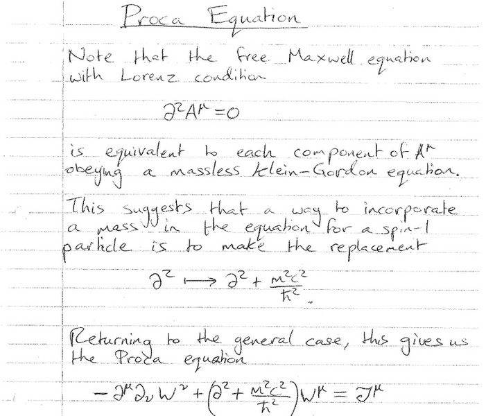

In our particle physics lecture this term comes up often, it doesn't look right to me but the lecturer uses it so it must be:
##{\partial }^{2}A^{\mu} = - {\partial }_{\mu}{\partial }^{\mu}A^{\mu}+ {\partial }_{\mu}{\partial }^{2}A^{\mu}##
I understand if you have:
##F^{\mu v} = {\partial }_{\mu}A^{v} - {\partial }_{v}A^{\mu}##
then
##{\partial }_{\mu}F^{\mu v} = - {\partial }_{\mu}{\partial }^{\mu}A^{\mu}+ {\partial }_{\mu}{\partial }^{2}A^{\mu}##
but I don't understand how a term with a single indices can give the same? How would you derive the first equation? I've tried chain rule but there seems to be an extra delta in there. Any ideas would be really appreciated.
That is wrong in many ways (eg. triple same indices)... are you sure it's [itex]\partial^2 A^\mu[/itex]?
Also you write things with two indices up = 1 index up and 1 index down.
[itex]F^{\mu \nu} = \partial^\mu A^\nu - \partial^\nu A^\mu[/itex]
So
[itex]\partial_\mu F^{\mu \nu} = \partial_\mu \partial^\mu A^\nu - \partial_\mu \partial^\nu A^\mu[/itex]
Now [itex]\partial_\mu \partial^\nu = \partial^\nu \partial_\mu[/itex] and the first term [itex]\partial_\mu \partial^\mu A^\nu= \partial^2 A^\nu[/itex]
So
[itex]\partial_\mu F^{\mu \nu}= \partial^2 A^\nu - \partial^\nu (\partial \cdot A)[/itex]
its from this first page of our notes:
So doesn't this imply that
##{\partial }^{2}W^{\mu} = - {\partial }_{\mu}{\partial }^{\mu}W^{v}+ {\partial }^{2}W^{\mu}##
or am I getting things mixed up?
thanks for the reply

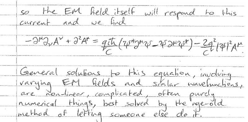

edit is also appears here:
please check again my first post for your own mistakes in your OP
Then I don't know, did you extract the Equation of Motion for the field [itex]A[/itex] (or [itex]W[/itex]) from the Lagrangian?
And, no, it doesn't...
I think you only did that for the Photon field (in a general gauge/not Lorentz gauge) :
[itex]- \partial^\mu \partial_\nu A^\nu + \partial^2 A^\mu = J^\mu[/itex]
And what you are told is that for the massive case, you only need to replace [itex]\partial^2 \rightarrow \partial^2 + m^2c^2/\hbar^2[/itex]. So for a massive field [itex]W[/itex] the above becomes:
[itex]-\partial^\mu \partial_\nu W^\nu + \Big( \partial^2 + \frac{m^2c^2}{\hbar^2} \Big) W^\mu = J^\mu[/itex]

Sorry I have no idea what that means, last year we didnt have the best lecturer and the Lagrangian stuff wasnt taught very well. I just noticed that the term
## - {\partial }_{\mu}{\partial }^{\mu}A^{\mu}+ {\partial }_{\mu}{\partial }^{2}A^{\mu}##
appers quite often and trying to figure out its origin

Ok, so would there be another way to write ## \partial^\mu \partial_\nu A^\nu + \partial^2 A^\mu## i..e something more condensed? where did the left hand side come from?
thanks again
I fixed the - sign for the first term ^_^
What do you mean "more condensed"?
The more condensed form would be to write the Maxwell equation [itex]\partial_\mu F^{\mu \nu} = J^\nu[/itex]
I think you posted the left-hand-side in your previous post #3

Let me try to elaborate what he/she does:
you have the Maxwell equation : [itex]\partial_\mu F^{\mu \nu} = J^\nu[/itex]
I've already written above what the [itex]\partial F[/itex] is equal to:
[itex]- \partial^\nu (\partial_\mu A^\mu ) + \partial^2 A^\nu = J^\nu[/itex]
Then he applies the Lorentz condition gauge, which says that [itex]\partial_\mu A^\mu = 0[/itex] And the above eqaution gives:
[itex]\partial^2 A^\nu = J^\nu[/itex] , which for a source free (free maxwell equation as he writes it) is [itex]\partial^2 A^\nu =0[/itex]. This is a set of four equations:
[itex]\partial^2 A^0=0[/itex]
[itex]\partial^2 A^1=0[/itex]
[itex]\partial^2 A^2=0[/itex]
[itex]\partial^2 A^3=0[/itex]
And that's why he says that the components follow a massless Klein Gordon equation ([itex]\partial^2 \phi + m^2 \phi =0 \Rightarrow \partial^2 \phi =0[/itex] for [itex]c=\hbar=1[/itex]). To incorporate the massive case, he says just replace the [itex]\partial^2[/itex] with + the mass...
