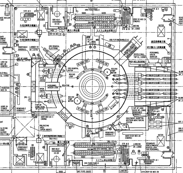

AFAIK, the space just below the reactor pressure vessel is densely packed with pipes, cables, and the hydraulic actuators of the conctrol rods. So any corium that breaches the RPV will have to melt through or flow around that mess before it reaches the concrete cap at the bottom of the drywell.
Could it be that the black smoke of #3 was caused by corium coming in contact with the hydraulic fluid of the actuators? The oil could have either burned inside the drywell, with whatever oxygen remained there, or it may have been vaporized and burned after escaping the drywell.
It seems that the steam emitted by #3 is leaking from the primary containment (into the refueling opening, and escaping from there through gaps around the service pool gates). The black smoke apparently came from the same area -- i.e. the service floor, as opposed from the lower levels. There seems to be little on the service floor that could burn.

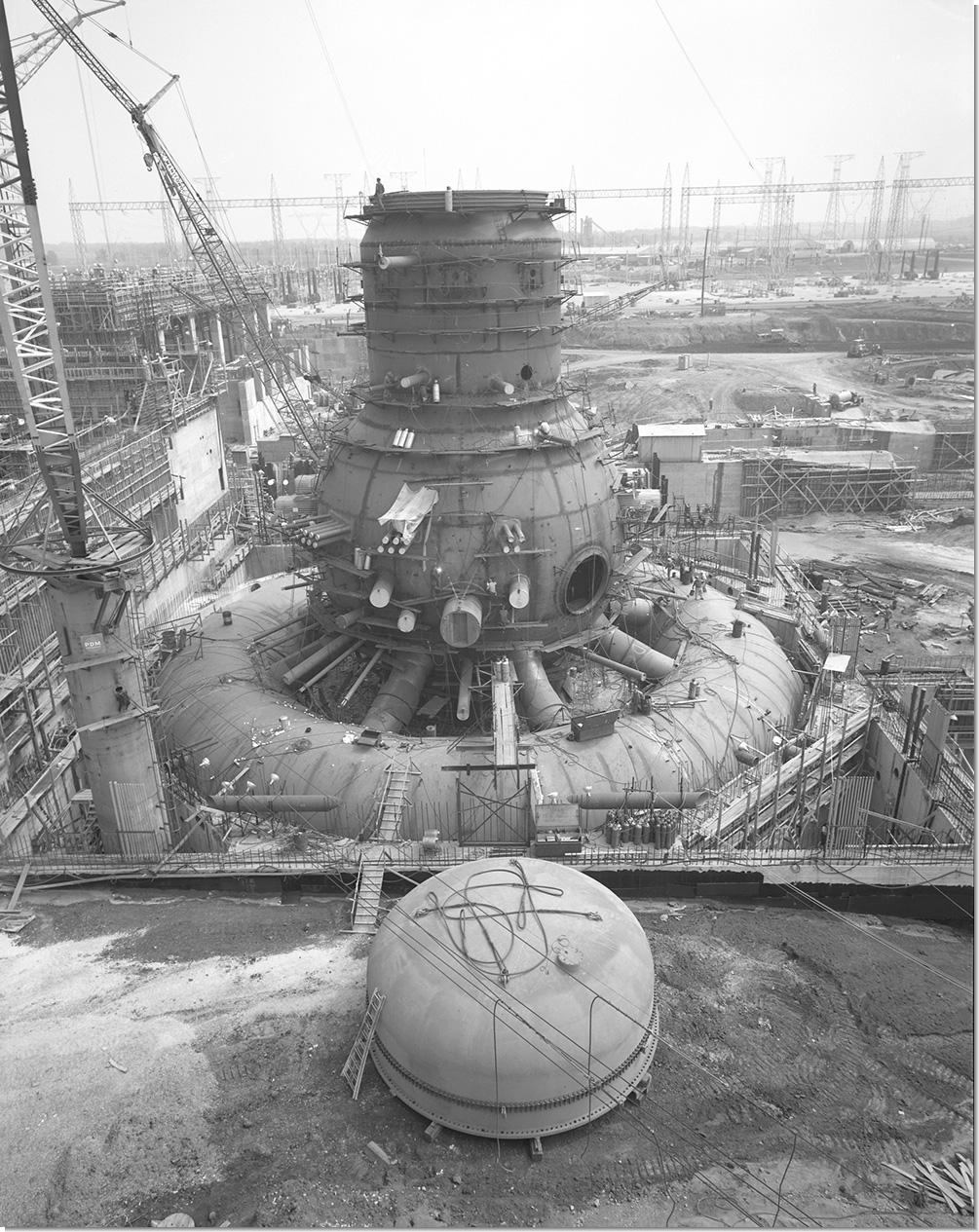

The RPV could not have ejected :smile:. It's big. We would have seen it.
We would have seen the plug. Ditto for the cap. Huge, hot, radioactive things, can't miss them.
Please, try to get a grip on the dimensions involved. For all your doom-and-gloom outlook, you seem to be constantly underestimating things. For instance, you are confused about the amounts of radiation that would be given off if a significant fraction of the core were to be ejected.
We're NOT talking pieces radiating a piss-ant 0.9 Sv/h that you can bulldoze over and go on with your day. Your scenario implies white-hot (1000 at least, but probably closer to 3000 degrees Celsius) corium dust and droplets and drops and blobs and bits of low-power rods from the outside of the core that may be "only" 900 degrees or so. They would be burning anything they land on, starting masses of secondary fires. The bigger bits would be vaporizing and cracking and spalling under thermal stress, giving off doses in the tens/hundreds of Sievert per hour, not that anyone or anything could get close enough to do contact readings. In the meantime, the finer stuff would be falling and depositing on every surface, a powder deadly to inhale, radioactive enough to kill you in hours or days. You'd get a Sievert or two worth of gamma just from staring at the site or the plume from two kilometers away, like those poor curious fellows who stared into the burning reactor from a bridge in Pripyat.
Good thing anything like that didn't happen, eh? :smile:
You assume I think that a nuclear explosion occurred. I did not say that.
I know exactly the size of the things that I'm talking about. So please stick to the facts, instead of the commentary.
If you can prove me wrong I will shut up.
First tell me what went through the hole.
Second tell me what has been burning in "masses of secondary fires" for eight weeks on the northwest corner of the #3 reactor building wreckage.
Third, tell me how the spent fuel pool - if that's where the explosion occurred, could have blown up the rest of the building, without destroying itself.
Facts:
1. something very big and round went through the roof right above the reactor core location.
2. Something has been burning on the northwest corner of the building for weeks, rendering that area a charred mess, with big holes going at least into the basement.
3. Tepco said for weeks the pressure vessel was intact and gave temp and pressure readings, which all must have been fabricated, since they now admit the fuel has probably melted through the RPV.
4. Some people did die in the explosion - possibly just as you have described - Internal bleeding and shock - like.
I'm not familiar with where you get your knowledge of exactly what would happen in an explosion scenario - as far as I know it's never happened before like this - so your speculation and detailed description is simply that - speculation.
I'm not a doomsdayer. I'm a realist. I'm happy to be proven wrong, but the facts support what I'm saying, no matter how much you wish they didn't.
