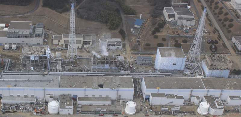

TCups said:
Then how about a huge blast from inside Bldg 4, maybe from hot fuel rods from SFP4 melting and dropping through, eventually into the torus suppression pool?! See post above.
TCups I admire your imagination and investigating every angle but here I have to disagree stretched a bit too far in my humble opinion
  • #1,892
I certainly hope so. . .
BTW, how do you explain the extent of damage seen to the exterior of Bldg 4? Far fetched as it seems, this is all I can come up with.
  • #1,893
TCups said:
The video of the blasts at 2, 3 were from the ground. More likely, things were starting to get "hot" and the camera crews were evacuated.
How the hell does the blast blow out all the east side panels at ground level, and yet, leave the north side panels at the same corner intact? It makes no sense.
I would love to get my hands on a full set of structural drawings of those buildings.
The only explanation I can put forth is a scary one --
1) the overhead crane protected the top north wall from the brunt of the blast force.
2) the explosion was more than hydrogen gas. It occurred in the spent fuel pool, and breeched not only the outside wall of the SFP, but also its inside wall and floor, with a large portion of the blast venting to the lower levels of Bldg 4.
The scary implication of this hypothesis is that the fuel in the SFP of Unit 3 melted "down" into the building or was blown down into the lower building when the hydrogen blast occurred. Nasty.
I have seen you guys ask questions that you are answering by yourselves over and over again. The direction of the blasts are shaped by the physical weakness of the structures around them, just like water flows where the least resistance is.
I have not followed your discussion much as I know from experience in reading numerous summary reports that we will only know the truth after the Japanese have decided what it is. That is going to be one hell of a report running thousands of pages, and it may not be written as it should if the decision is made to cap the whole reactor building, if, indeed, the reactor containment vessel exploded on three. Right now, all of the guess are just guesses. Since I am days behind most of your observations and have trouble telling one wall from another I am in awe of your summaries so far.
Let me go back and ask a simple question, "What was the large structure that was lifted hundreds of feet into the air that we can clearly see in the dark cloud explosion of Reactor Three? You can see it coming back down out of the top of the cloud and impacting the ground. Exactly where, I do not know, but I am certain you guys have already figured that out."

AntonL said:
Cannot be confirmed, however I cannot imagine the quake to this kind of damage to the welds
I wonder if these are welds. It looks like something I see whenever I drive home from the city center - there is a pipe used to transfer heat from a CHP station to buildings in one of the city districts. It looks similar from the distance, but it is not welded, just a riveted metal sheets (relatively thin ones) that protect insulation below. You can rip the rivets with a good kick.

  • #1,907
Borek said:
Have they survived quake intact?
What Anton is seeing are not ruptured welds. At least I do not think they are welds. Most of thpse external pipes have lagging on them to prevent people from getting burned or to prevent collection of ambient condensate which can rust the pipes. The lagging is usually covered by a thin metalic foil of some sort, most likely aluminum or thin stainless steel. It would be subject to shock wave wrinkling.
  • #1,908
Those pipes are as far as I know vents from the Torus (and containment?) to the exhaust-stacks.
The bursting of the pipe could be due to the earthquake - but it could also be due to HIGH PRESSURE SHOCKWAVE inside the pipe.
Though my guess would be that such a shockwave would rupture the pipe in where it bends - so I lean towards the "buckled in earthquake" theory.
But keep on analysing TCups, I appreciate your thoughts.
