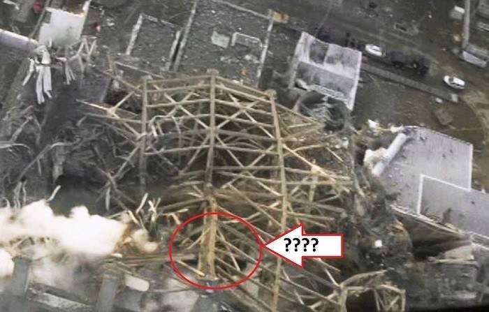

Some components we were aware on the early days regarding the rubble on top of U3 can be seen here in operation:
http://photo.tepco.co.jp/index-j.html
For example the 'spanner':
