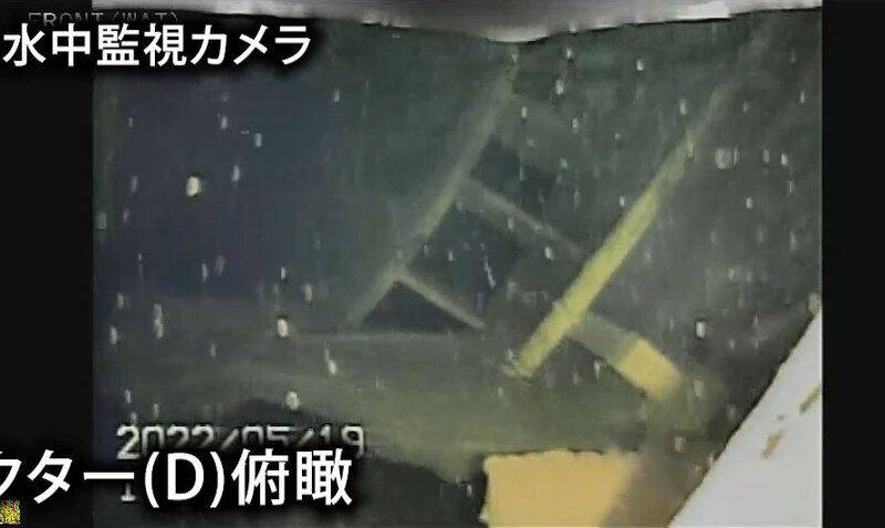

Speaking of imagery from the upper inside pedestal area, one can get unit 2 and 3 mixed up. Main rule is, If it doesn't look like a complete wreck, it is from unit 2.
Being under water doesn't help.
What are these instruments? Looks like they experienced some physical abuse. I think maybe @Hiddencamper has been under a BWR...
https://www.flickr.com/photos/simplyinfo/albums/72157683819520183/page2
The images are looking up at the hanging bottom ends of some of the Control Rod Drive Mechanisms (CRDMs) in unit 3 (except for the smaller one with the funny bent and cut off thing coming out it, which is some other kind of tube, probably for some instrumentation or sensors). There should be looping black tubes connecting up to all the bottom ends, we see only some cut-off remnants of the metal leads for signal readouts, which were inside the tubes. During the pedestal inspection, the robot shot videos of this same area on two separate days, thus providing a view from two different angles.
In the top left hand side of the image to the left below, something looking like being of the blackish lava type of unit 3 is visible- apparently a portion of it has come stuck up here at this level of the pedestal. In the top middle of the image to the right, we see reflections from the robot lights in the water surface up above. We have unobstructed view from below to these tormented 'thingies' because the heavy metal construction that should normally be underneath them, has gone. According to the video, in the visited part of the pedestal of unit 3, the robot didn't find anything at the level of the CDRMs bottom end, that didn't look a total wreck.
jim hardy said:
i'd say there's been some violence down there.
Yeah. "Let us give it a good hosing before we jump to the conclusion that anything is damaged" doesn't seem to apply. Here is a cut away model of a BWR which I fell over. It is simplified, but quite instructive, if one is not a BWR guy. Down below we see the CRDMs in their welded-in housings, coming down from the bottom outside of the RPV into the pedestal area, and, inside the vessel, the main components the pistons of the CRDMs are working with.

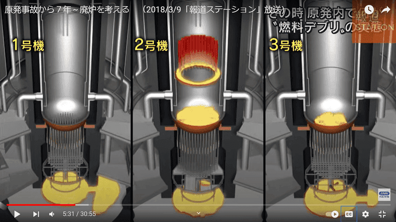

On page 8 are estimates at the current time of the whereabouts of debris ( in total 279, 237, and 364 tons in unit 1, 2 and 3 respectively). Of which, according to the estimate, very little (15, 42, 21 tons respectively) remain inside the RPV bottom, while the main part of the debris (264, 195, 343 tons in unit 1, 2 and 3 respectively) is estimated to have accumulated at the bottom of the PCV, inside the pedestal, or flowed outside it through the workers entrance.
Debris, that would include fuel debris, as well as debris of other degraded parts of the RPV internals, I reckon.
If this was already discussed i apologize. News to me, though
http://www.jaif.or.jp/en/new-data-obtained-on-debris-locations-based-on-temperature-changes-using-reduced-injections-of-water/
TEPCO made use of records of dozens of thermometers installed in each of the RPVs and elsewhere at Units 1 to 3. At Unit 1, temperatures near the control rod drive mechanism below the RPV rose as the volume of injected water decreased. The power utility believes that the debris that fell toward the bottom of the RPV was caught by the mechanism, becoming a heat source. Most of the debris is thought to have dropped to the bottom of the containment vessel.
At Unit 2, the temperature at the bottom of the RPV rose distinctively, so TEPCO thinks that there may be debris present there. At Unit 3, meanwhile, the temperature of the water in the containment vessel was higher than at the bottom of the RPV. TEPCO believes that most of the debris there dropped from the RPV, remaining at the bottom of the containment vessel.
http://www.jaif.or.jp/en/fuel-debris-at-fukushima-daiichi-2-mostly-found-at-bottom-of-reactor-pressure-vessel/ The results match those of the investigation of temperature change using reduced injection water. The company will continue its investigations and try henceforth to ascertain the positions of the debris more accurately.
Where there's heat there's fuel.
Significant melt-through on 3, not 1 & 2 ?
Still tentative but based on real data and sound reasoning .
And not contradicted by photo evidence so far.
Samples will nail it down.

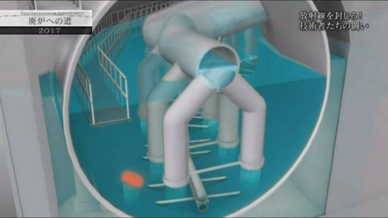

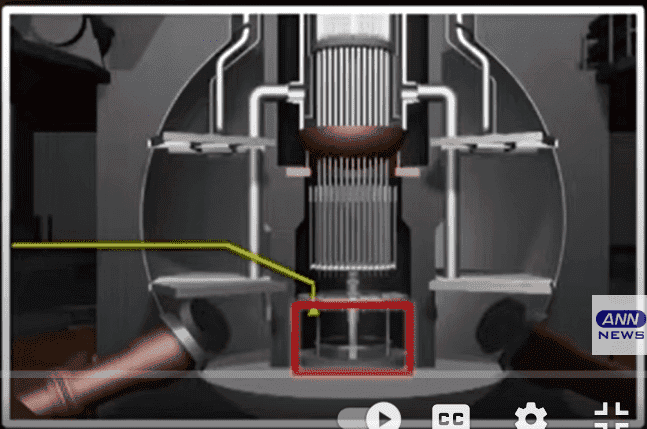

On page 8 again, interestingly there is an infographic showing an exemplary RPV with a lot of its CRDMs apparently having fallen out from the RPV bottom complete with their housings. I don't remember seeing that possibility indicated in any infographics from before the pedestal area of unit 3 was inspected.
Something inspired that artist. A photograph would be nice..

jim hardy said:
Something inspired that artist. A photograph would be nice...
Yes. Sadly we have only video-snippets from unit3, those which Tepco selected for release, and nothing there seems grossly inconsistent with the artists expression.
I understand why they release information slowly both to quell wild speculation and to make sure they have answers to the reporters' questions that'll arise.
Right. If the robot actually managed to shoot a scene with CRDMs neatly lined up in place in unit 3, Tepco wouldn't necessarily include it in the video-release.

jim hardy said:
Setting emotions aside --- were the CRDM's and vessel bottom found all intact and a significant amount of core not in the vessel the obvious question would be "How then did it get out?"
That would be an unexpected outcome. I'd say, least implausibly through the RPV wall somewhere close to the bottom and above the RPV skirt. Debris could then be found outside the pedestal. We do have splatter on the CRD rail outside the pedestal in unit 2, but fortunately also an apparent localized damage of CRDMs up and to the left from the degraded rail end, inside the pedestal, to connect the splatter with.

MadderDoc said:
the second day of the expedition under unit3, there is another interesting snippet with a view up to a section of remains of this bolted layer. It must be shot somewhere across the room from the pedestal entrance, close to the opposite wall. It is from about 0:35 in this
About 1:35 you can see what i think is a CRDM bottom flange above the rack, looks like it's where it belongs.
But yikes what a mess. Broken pipes, sludge,
need those samples..
jim hardy said:
About 1:35 you can see what i think is a CRDM bottom flange above the rack, looks like it's where it belongs. But yikes what a mess. Broken pipes, sludge, need those samples..
Yes, you see several CRDM bottom flanges up there above the bolted layer in that snippet. Bordering to that same area, you see some, er, sludge, which appears to have come down and solidified while slithering down through the bolted layer. After solidification, apparently the bolted layer has given in towards center of the construction, leaving 'sludge-stalactites' hanging on there, close to the wall, in an awkward skewed direction relative to vertical. Samples would be nice, but it is kind of a samplers nightmare, considering the inhomogenity of the mess.
BTW, in the same video, the 'layer cake' we talked about earlier appears at about 1:53. I've come to think of that whatever solidified material those succesively added layers consist of, one cannot assume that the toll of time doesn't affect such solidified material. Erosion or crack off could explain the now ragged edges of the layers. They may originally have been laid out more 'elefant foot like'.
