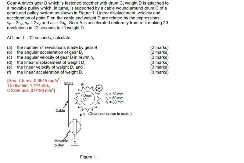

Since
Gear A
Vi=0
t=12s
θ=40∏
as given in the question, can I assume that Vi=0 t=12s for Gear B/Drum C as well?
If not why?
Thanks..
You can apply rotational and translational kinematic.
For question (d) the question is displacement, answer given velocity
what do you mean?
Sure.
