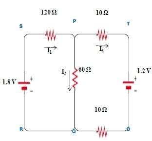

Find I1,I2,I3
Attached the circuit diagram
2. The attempt at a solution
I1 - I2 + I3 = 0
-120I1 - 60I2 + 0I3 = -1.8
0I1 -60I2 -20I3 = -1.2
I1 = 1/150 A
I2 = 1/60 A
I3 = 1/100 A
Is that correct ? The answer is my textbook is different :(

I1 - I2 + I3 = 0
Nooo … :redface:

I took the 1st loop clockwise and the second loop anticlockwise, so why the 1st equation is wrong then ?
Can you please explain further ? :)

Your 1st equation (I1 - I2 + I3 = 0) doesn't involve loops, it's for a vertex, so it only involves "in" or "out".
According to the diagram, I1 is in, and both I2 and I3 are out. :smile:

But, If I made it I1 - I2 - I3 = 0, I1 = 0, I2 = 0.03, I3=-0.03, that sounds correct ?

No … how did you get that? :confused:
Kirchhoff's first law says that the current into a juction is equal to the juntion out. So use that on the top middle junction and have another think about that first question (remembering the directions of currents!)

By substituting it with the other 2 equations (using the calculator eqn solver):
I1 - I2 - I3 = 0
No, I2 and I3 are in opposite directions.
aha
Now it gives correct answer (0.02,-0.01,0.03), I though direction of I3 was same like I1, because of the direction of the drawn battery poles :shy:
