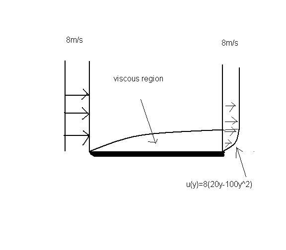

I am trying to solve this problem using lagrangian motion but I have no idea how to use it.
It can be solved using mass conservation and force momentum equation but we are supposed to solve it with continuity.
How would I go about this?
Continuity:
[tex]\frac{ Dp }{Dt} = \delta u / \delta x + \delta v / \delta y + \delta w / \delta z[/tex]
Now the problem is this:
Calculate the drag force acting on the flat 2m wide plate. Outside the viscous region the velocity is uniform. Use density = 1.23kg/m^3
What I can say is that, [tex]\frac{ \delta p }{\delta t} = 0[/tex]
PIC
  • Sketch of flow over a flat plate: uniform 8 m/s stream enters from the left and right, with a viscous boundary layer growing along the bottom plate. Labelled u(y)=8(20y-100y^2) at the right edge.
Nobody with a clue on this one?
The exact question states:
b) Solve the problem using a control volume with the upper boundary a streamline (no mass flux crosses a streamline)
