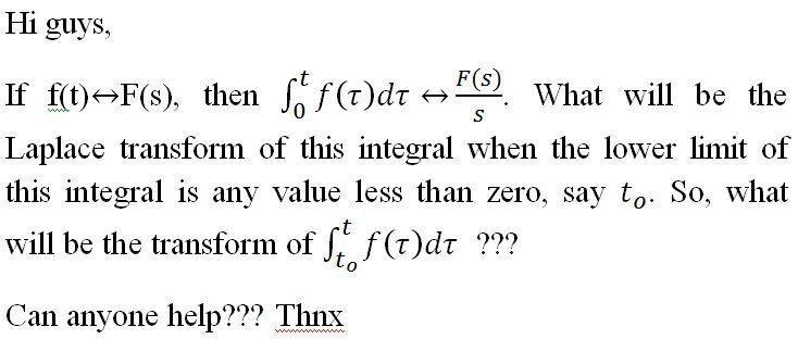

Hi guys,
would you please help me in my question which is in the attached image?
Thanks
Use:
<br /> \int_{t_{0}}^{t}=\int_{t_{0}}^{0}+\int_{0}^{t}= \int_{0}^{t}-\int_{0}^{t_{0}}<br />
The second of these integrals is a constant.
