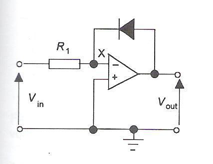

I am trying to understand the derivation of a logarithmic amplifier as shown in the figure attached.
The diode has a non linear characteristics represented by V=ClnI,where C is a constant.
Then since the current through the feed back loop is the same as the current through the input resistance and the potential difference across the diode is -Vout,we have
Vout=-Cln(Vin/R)=Kln(Vin) where R is input resistance.
What I can't understand is the step in bold,what mathematical rule is used between the two equations?
Thank you in advanced .

Vout = -Vdiode = _____
Can you take it from there?

Nothing adds up:
[tex] V_{out} = -C \ ln(V_{in}/R)[/tex]
[tex] V_{out} = -C \ ( ln \ V_{in} - ln \ R ) [/tex]
[tex] V_{out} = -C \ ln \ V_{in} + C \ ln \ R \neq K\ ln \ V_{in} [/tex]
In addition, why are there dimensioned units in the log argument?
You need better source material--the equation is beyond wrong.
I believe the third expression has presumed R is a constant. Specifically, K is chosen for a certain R. It shouldn't be written that way (all three expression equal) because the second equals sign has that qualification (that R is a constant and its effect is included in K) but the first equals sign does not have that qualification.

I understood your first point that R (input resistance) is included in K but I can't understand is how R is included in K.In the previous post by Phark showed that
Vout=-ClnVin+ClnR is not equal to KlnVin.Can you state the steps how you concluded that?
That was what I thought at first too, but Phrak showed us that it is wrong. R could be included in an additive constant, but not in a multiplier because of the properties of logarithms.
Have you been told the diode equation, which is the basis for this discussion?
For a diode,
i = iS (eV / V0 - 1)​
where iS and V0 are constants for a particular diode.
But, iS is often in the nA or pA range for many diodes, so the "-1" can be ignored when the current is much higher than that. With that approximation we have
i = iS eV / V0
To get the correct equation for gain in the op-amp circuit, you need to do 2 more things:
  • Solve the above equation for V
  • Use Ohm's law for the resisitor R to get i in terms of Vin and R
As a final step, you could also combine all the constants in the final equation into just 1 or 2 constants such as C1 and C2. Remember that R is also considered as a constant in this particular circuit.

I tried follow the above steps by Redbelly,please tell if I did wrong or not
given I=Ise^Vout/Vo
I made Vout subject of the formula gives Vo(lnI-lnIs)=Vout
using Ohms Law did I in terms of V and R
Vo(lnVin/R-lnIs)=Vout
Vo(lnVin-lnRIs)=Vout
VolnVin-VolnRIs=V (I think that VolnRIs ~ 0 ,because Is is approx 0)
Therefore VolnVin=Vout or KlnVin=Vout
given I=Ise^Vout/Vo
Vo( ln(Vin/R) - ln(Is) )=Vout
Vo( ln(Vin) - ln(R Is) )=Vout
Vo lnVin - Vo ln(R Is) = V
Looks good up to here.
(I think that Vo ln(R Is) ~ 0 ,because Is is approx 0)
Not quite. If Is is "≈0", then ln(R Is) would tend to -∞, not zero.
As I see it, the ln(R Is) term should be kept, and perhaps incorporated into a single constant if you wish. This does disagree with the equation given in Post #1.
Thank you for your replay the final answer is I think VolnVin-C=Vout
Might the equation be KlnVin=Vout or VolnVin=Vout for a particular R I think?
In other words Voln(RIs)~0
Thank you for your help!
Technically yes, for a particular R in suitable units ... but this would not be a practical value for R.
We would need R Is = 1, in some system of units, for the ln to be zero. But for realistic values of Is of 10-12 to 10-8 Amps, R would have to be between 108 to 1012 ohms! It's simply not practical to use such large resistor values in most circuits.
So there really needs to be a constant term added (or subtracted) in the expression.
