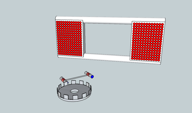

to clarify my question and give you a reasonable motive behind my questions, i drew up a picture.
my question is when the reluctor wheel passes past one of one magnet what kind of response will i get in the other magnet?
-will there be an increase or decrease in the other magnets strength depending on the direction of the windings in the coils?
-will there be an equal response from each magnet across the grid as a metal object passes by it? "depending on the accuracy of each coil of course."
-could a magnetic image somehow be broadcasted from one grid to the other through the use of mercury or metal filings on one grid and a metal object passing over the other?
these are just a couple of the questions i want answers to. in order to build a grid i need time and money. just want to know if ano of the answers are already out there before i waste both.
i already know that a small amount of voltage will be induced in the coil of the first magnet. but is that voltage enough to change the magnetic properties of the other magnet?

in the picture there are actually two devices.
ill break each one down a little further.
the smaller one is a generic view of a wheel speed sensor found on a vehicle.
I'm an automotive technician so please excuse the terms i use. a reluctor wheel or tone wheel is the object connected to the axle shaft behind the tire and it spins in relation to the tire.
the permanent magnet that is closest to it would be considered the wheel speed "sensor". on the vehicle it is mounted stationary on the suspension. as the tone wheel rotates, the fins pass through the magnetic field. as each fin exits the magnetic field it induces a small amount of voltage in the coil. so i kind of referred to it as the generator in my brain...
the second magnet and coil would be used as an electro magnet, although it is in fact a permanent magnet.
in theory the voltage induced in the first magnet would be transferred to the second magnets coil. this would manipulate the magnetic field of that magnet for just a split second causing it to either weaken or get stronger.
this would " in theory" allow something placed on the verge of being pulled toward it to either be pulled toward it or let completely free.
the larger of the two devices is a grid of these individually wired 1:1 and then placed in sequence. this means that the top left hand magnet on the left grid is wired to the top left hand magnet on the right grid. they would all be wired in reference to where they are at on each grid.
if my first theory is correct, and a magnets field can be manipulated and broadcasted to a second magnet over a twisted pair, the grid device could be used to magnetically broadcast from one grid to the other.
if laid down flat on a table this grid could possibly be used for some interesting experiments. a sheet of glass could be laid over it and either metal filings or mercury could be placed over one grid, and the second grid could be used to manipulate the shape or movement of the medium by moving a metal object over top of it. it may not be an equal reaction, but any reaction would be a start to something new.
if one permanent magnet can be manipulated remotely by another, "without ANY source of battery power" other than magnetic induction itself, it can be a usable function.

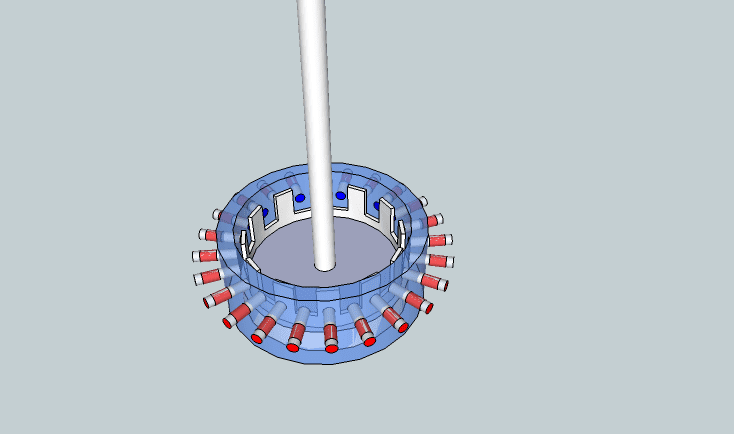

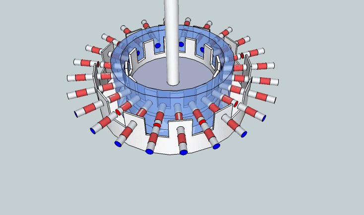

here you can see one of my project ideas. there is more to this project that you can't see, and i won't be posting it up any time soon :wink:
in this picture the reluctor would be spinning and creating 12 pulses at the same time and alternating between 2 sets of magnets 24 in all. each magnets pulse could be used individually or together in two groups of 12.
so, if some how i was able to get one volt from each coil, wiring each group of 12 in series would add up to 12 volts. but I'm not expecting 12 volts to come from this.

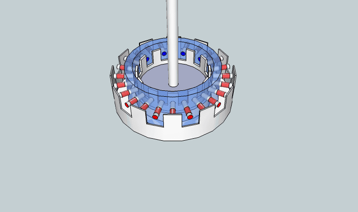

here the reluctors are doubled up and move together. this induces both ends of the magnets. in theory the magnetic field will be stretched out in both directions and then once the reluctor tooth passed it would collapse into itself in both directions. what it would produce is unknown to me.
what if the same poles were held at close proximity to each other and a shield was passed between them? would the magnetic fields still be attracted to the reluctor, and once it passed by, would the poles repel each others fields causing a stronger collapse resulting in higher inductance readings?

I will say it again...take the magnets out if the coils!...they are actually working against you!
Put the magnets in the reluctor fins, put iron cores in the coils.
In fact, you could benefit from the 'outside' reluctor but it does not need to be spinning and you would benefit from core in between the coils, too...this is call the 'stator'...
Just go an open an electric motor and you will see what I am talking about...you will see coils wound around laminated core.
Also, you should probably visit some http://www.allaboutcircuits.com/vol_2/chpt_1/1.html" page and read some.
You don't have to experiment and re-invent the generator, you know, they have been around for quite some time.
