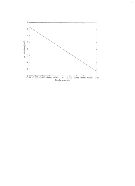

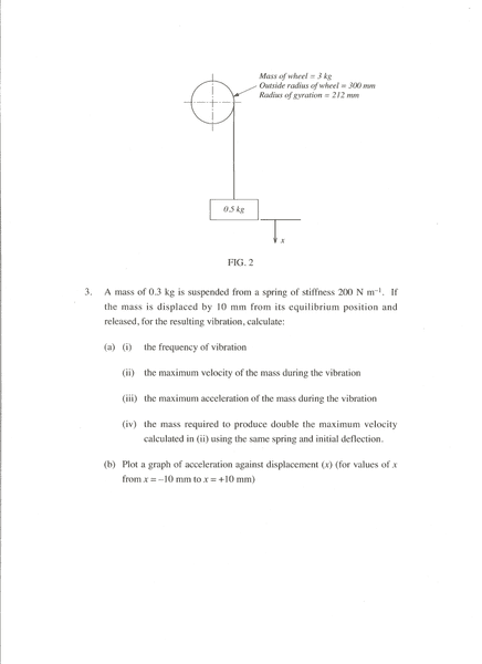

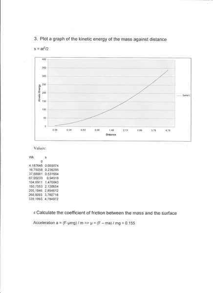

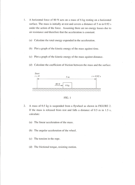

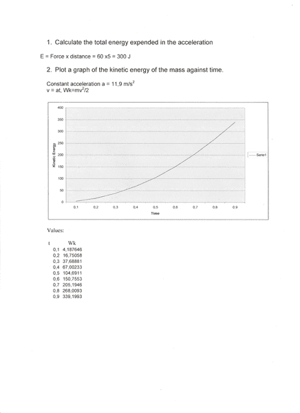

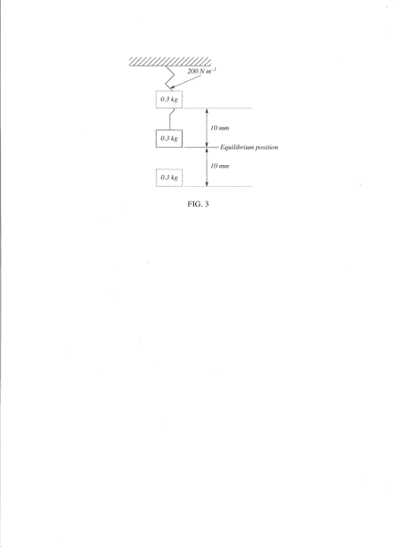

Please could you look over my questions and what answers I've come up with please, and see if I have done them correct?
Thanks a lot
Questions:
My Answers:
Thanks :)
I've just realized that answer 1a) is incorrect :( so please ignore that one.Thanks :)
