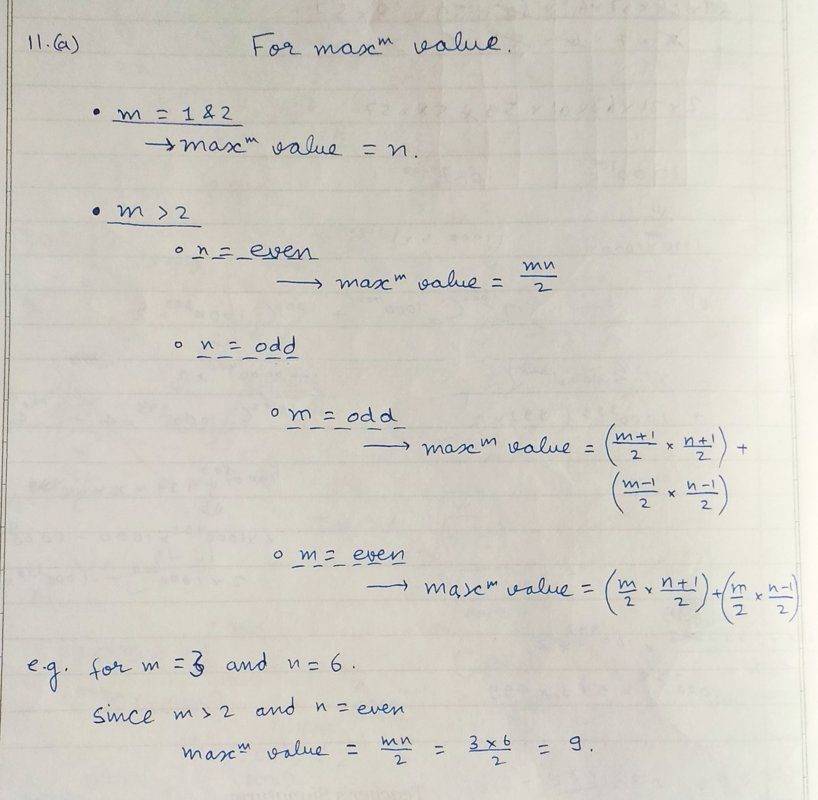

fresh_42 said:
This is close, but for ##n=6=3k## and ##m=3## you have ##6## knights, but ##9## are possible.
It is better to distinguish the cases ##m=1,m=2,m>2##.
In my answer I have already told that required number is always maximum in case 2 except for ##m=1## which will give ##9## for the given case. However if you want me to distinguish the cases as ##m=1,m=2,m>2##, here it is.
on Phys.org
  • #62
You can simplify the formulas of n=odd.
For n and m both odd the formula can be simplified to ## \frac{mn+1}{2} ## .
For n odd, m even, the formula can be simplified to ## \frac{mn}{2} ## .
This way both the cases of n feel interconnected.
##m=2## and ##n=2## allows ##4\neq n## knights.
Pi-is-3 said:
For ##n## and ##m## both odd the formula can be simplified to ##\frac{mn+1}{2}##.
For ##n## odd, ##m## even, the formula can be simplified to ##\frac{mn}{2}##.
it can be further simplified to ##\lceil \dfrac{nm}{2}\rceil##.
Nobody with an idea how to find the correct number for part b)?
You are right but I didn't simplify the formula intentionally. Because this way one can easily figure out how I have derived the formulas.
  • #67
fresh_42 said:
m=2m=2m=2 and n=2n=2n=2 allows 4≠n4≠n4\neq n knights
Yes you are right. There is an exception for such small boards that I couldn't figure out.
fresh_42 said:
it can be further simplified to ⌈nm2⌉⌈nm2⌉\lceil \dfrac{nm}{2}\rceil.
What is a 'ceil'?
  • #68
You have almost everything right except for ##m=2##. The example of a ##2\times 2## board can be generalized to ##n\times 2## boards. The formula is a bit tricky. I suggest to write ##n=4k+r\, , \,r=1,2,3,4##.
What is a 'ceil'?
Rounded to the next upper integer.
You can give an easy and straight argument if you look at an actual board and observe what a knight move does.
