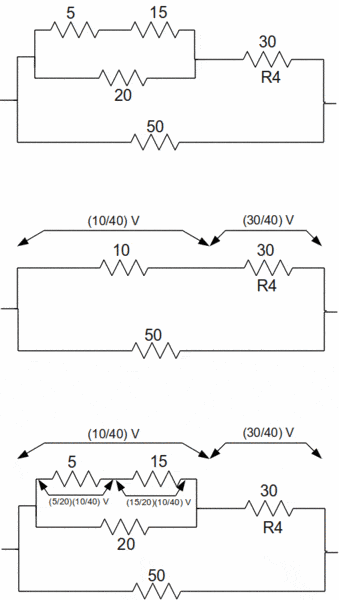

  • #31
This is where I inadvertanly reversed the term order, relative to the first equation.
R5 = 50 so power in R5 is
V2/50
R5 is the only resistor that experiences the full voltage, V.
All the others see V reduced by some factor.
However you still need to check that R5 reaches 1 watt first, since we also divide by the resistor value to get the power.

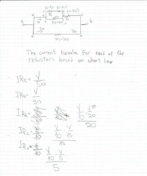

1) I've scanned my second attempt of the solution
2) I've also tried to calculate for I, is my equation correct?
Also, as far as how you've gotten the the formula for each of the resistor, it's basically:
"the potential difference of the resistor (or the entire parallel region), divided by the potential difference across the entire closed loop, divided by the potential difference of the resistor."
I've tried to derive that from your formula. I don't recall it being explained to me that way.

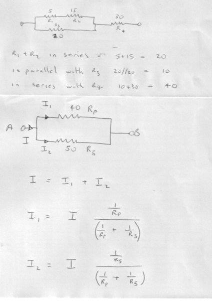

  • #34
Oh dear, you really are better at mechanics.
I will post some more after lunch. Meanwhile perhaps you would like to think about this.
Why does your 'solution' equate the total power to 1 and then 300?
The current method is not really derivable from the voltage method - V does not actually appear anywhere.
Kirchoffs laws, loops and such won't help here. I'm just using the basic definition of series and parallel connections, ohm's law and the equation for power.

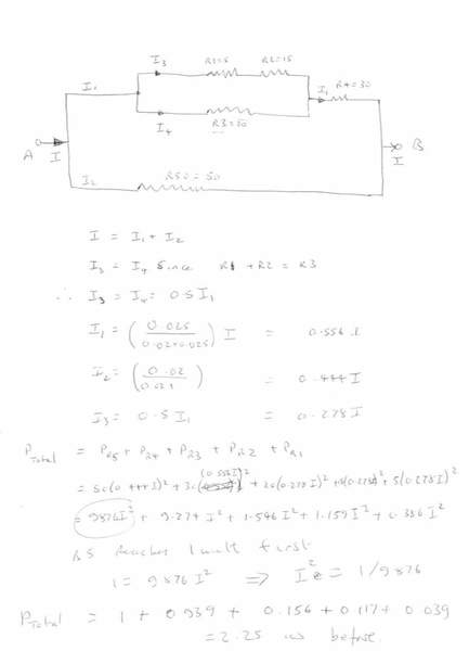

  • #36
There are two separate issues here.
One is arithmetic and I will sort that first by finishing the solution (in the attachment).
Note that in order to back substitute and calculate the total power I only need to calculate V2.
I don't need to take the square root and find V.
I have lined up the calculations so the individual contributions from each resistor is shown term by term.
Is there anything you don't follow?

  • #42
Okay, I am looking back at Studiot post. You've found Ptotal, they're asking for Pmax. They didn't ask "which resistor will be damaged first", they asked "what is the max power you can spread around the circuit without causing damage to any of the resistors"..shouldn't the answer be in terms of Pmax = ?
  • #43
Yes I should have said Ptotalmax not just Ptotal when I put in the value for V2
The maximum safe power in that network is 2.25 Watts.
At that power input R5 is at its rated limit and if you look carefully R4 is pretty close as well.
Are we all agreed now?
