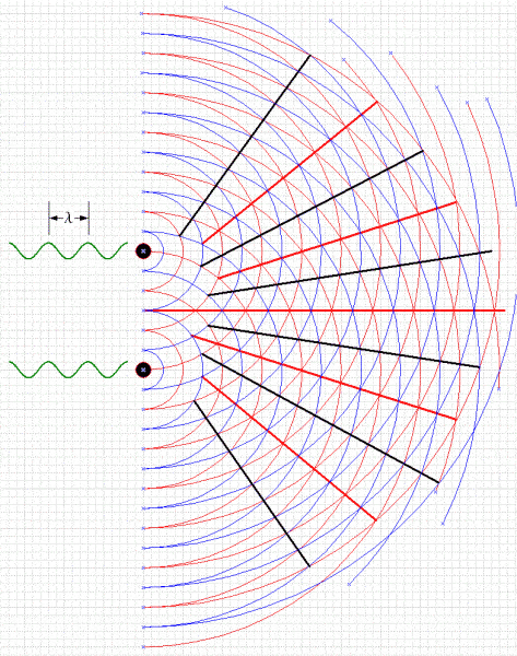

Here's a big drawing of an interference pattern. The wave peaks are shown as red circles, the troughs as blue circles. Lines of destructive interference (lines of nodes) are in black. Lines of constructive interference are in red.
As you can see, the waves from the sources are more parallel when they meet further away from the sources.

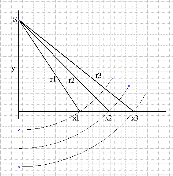

Here's a diagram that illustrates what I meant by the geometrical projection effect:
Successive wave peaks from a source S positioned at distance y above the central horizontal line of constructive interference meet the line at x1, x2, x3, and so on. It should be clear that x2-x1 is longer than x3-x2, and that neither is exactly equal to one wavelength. In fact, one wavelength would be equal to r2-r1, or r3-r2. Or two wavelengths would be equal to r3-r1.
Distances r1, r2, etc., should be fairly easy to measure. Perhaps if you can count peaks along the line of antinodes and measure the radial distances to the ends you can get a good estimate of the wavelength.
I understand the first picture you posted (with the different colors representing peaks and troughs). And whenever I put the ruler to the screen, I can always calculate the wavelength to be the same along antinodal or nodal lines, wherever I measure. This is not the case with the black and white picture. I do not get how to read the black and white picture. Can the black lines represent peak meeting peak or trough meeting trough? Then wavelength would be double the distance between two black lines.
