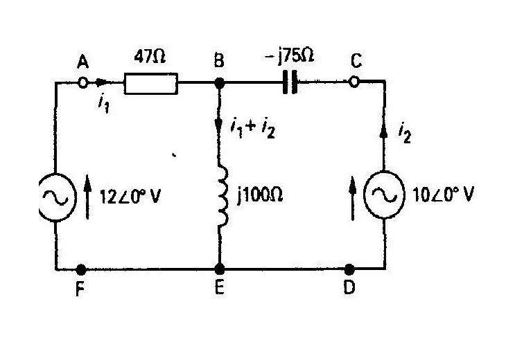

shaltera
91
Use mesh current analysis to determine I1
Loop 1
47i1+j100(i1+i2)-12=0
(47+j100)i1+j100i2=12
Loop 2
-j75i2+j100(i1+i2)-10=0
j100i1+j25i2=10
j100i1+j25i2=10 (-4)
-j400i1-j100i2=-40
-j400i1+(47+j100)i1=-38
j400i1-i1(47+j100)=38
(-47-j300)i1=38
Is it correct?

A slight problem with the voltage value indicated above.
40-12=28
Well spotted
shaltera said:
40-12=28
Well spotted
Right. Now finish, isolating i1 and writing it in a standard form.

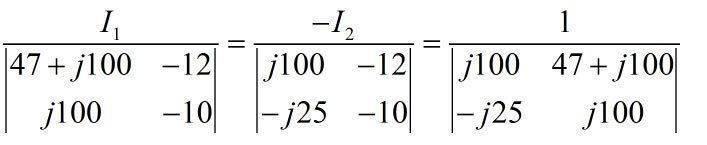

Thanks.I decided to use matrices to solve this problem.I hope matrices is correct
For i1 I have -0.0557<84.63deg
Is it correct?

Ok.How about calculations in a second equation (i2) in P17?Is it correct?
