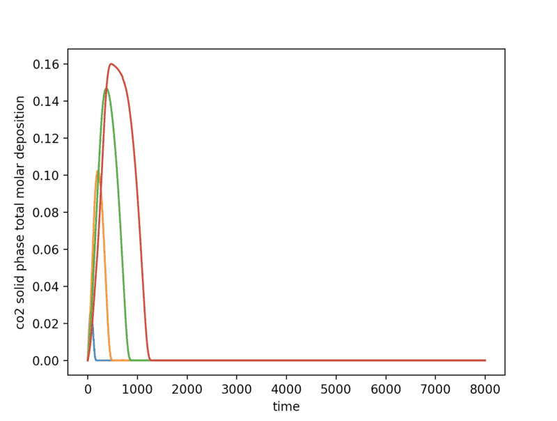

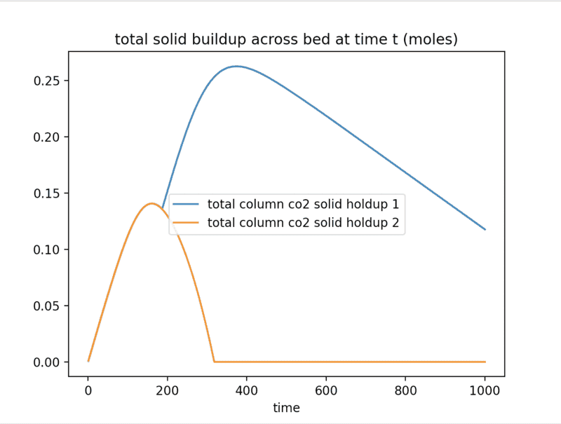

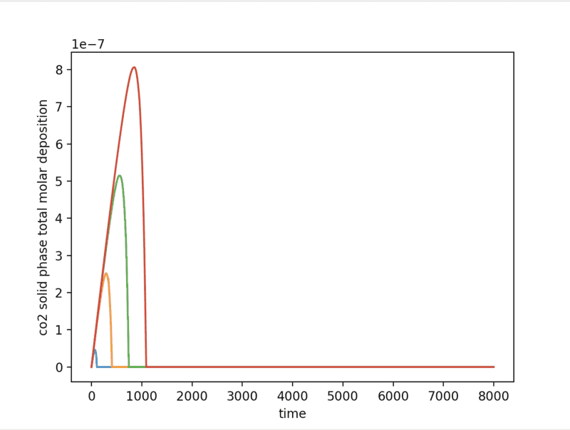

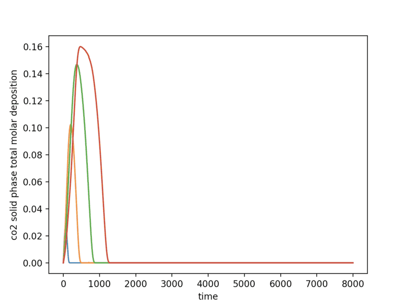

I've simplified to n=1. Some plots look as expected. The solid deposition of CO2 follows an n shaped curve for example. I've been debugging for effectively two weeks now (crippling but a good learning experience), and I almost have plots that look as expected. I have one question currently - what should the plots look like at t=0? i.e. should there be a jump initially up to a given value, or should this jump exist at all? If it shouldn't be there then this likely indicates that I'm setting up the boundary conditions incorrectly
For example the plot for qGI (gas interface heat flux) jumps from zero to 350 initially and then follows the expected trend. Should this just start at the max value?

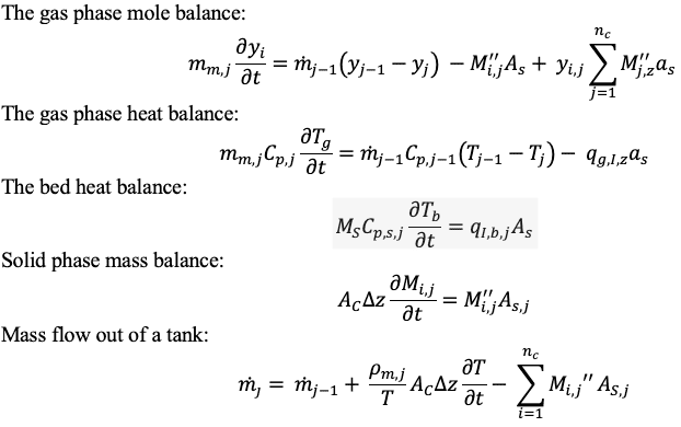

In short, the question is, for the equations below, when setting them up at the boundary (n=0), what values of ##y_{j-1}##, ##y_j##, temperature for the molar deposition term, temperatures for the heat flux terms should be used? Is it always the 'current' temperature, and never the initial/boundary temperature?
Of course, assuming we can agree on what n = 0 represents.

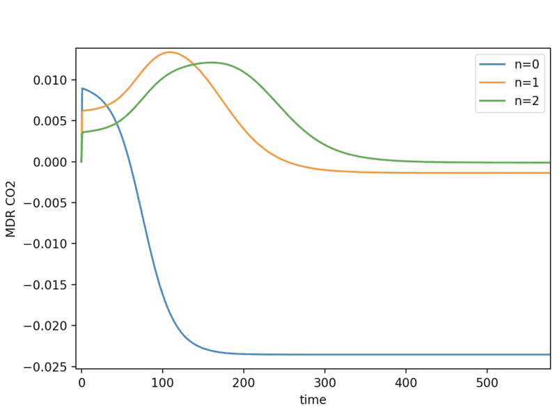

Lastly, post 161 had a question about the initial 'jump' of certain values from zero up to a maximum value, rather than them starting at this value. Is this initial jump expected (such as in the ##Q_{GI}## plot), or does it indicate I've set something up incorrectly?

Sorry post #181! Bad eyesight. The ##Q_{GI}## plot

In your graph of Q, which tank does this apply to?
Chestermiller said:
I'm still confused as to what you are saying n represents physically. I always though it was the total number of tanks being used in the calculation (equal to the length of the bed divided by the grid spacing).
I agree yes it is this. Ah I think I see the confusion now. When I wrote n=0 earlier, I was referencing the zeroth tank i.e. the first tank in which the ODEs are being evaluated. I did not mean that there were zero tanks. Does this solve the confusion?
For the Q graph, this applies to the first tank (zeroth index). Is this expected?
So it is tank 1?
I don’t think so; initially the bed and gas are at the same temperature, right?

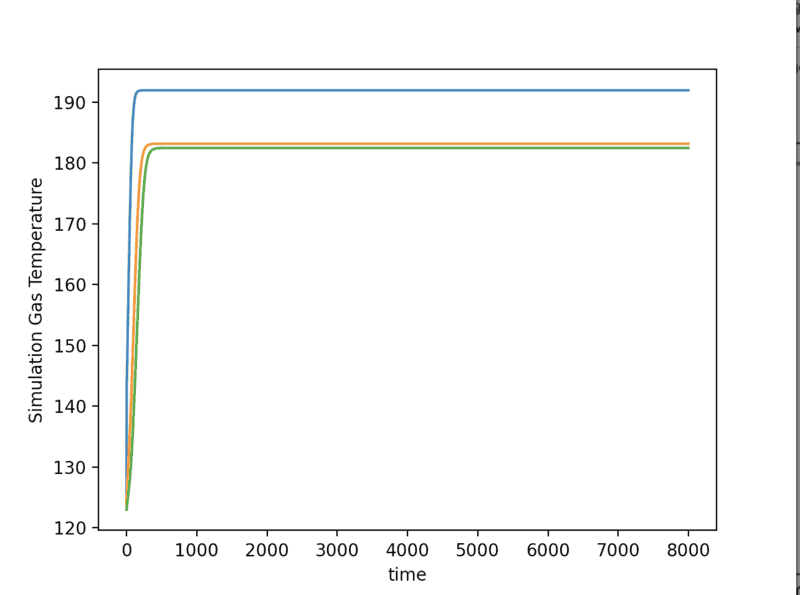

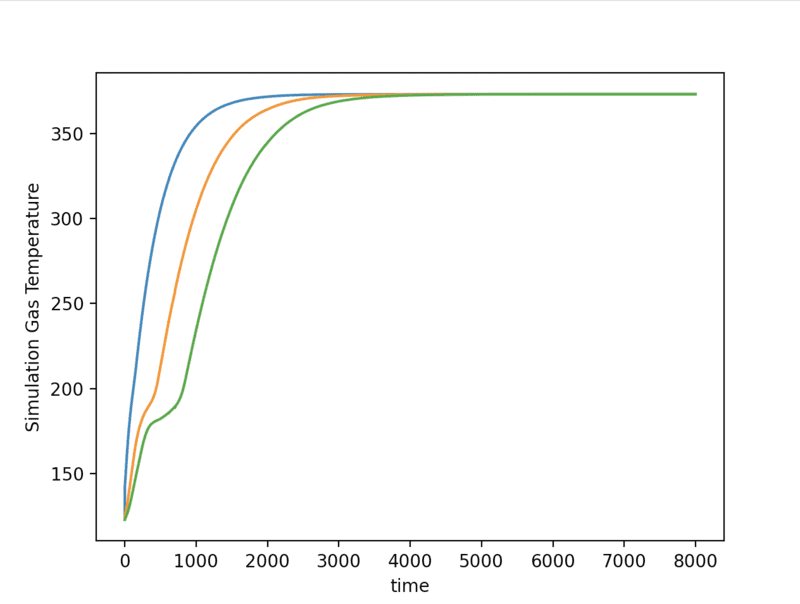

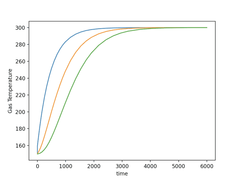

Things seem to look a bit better now. However I'm completely puzzled as to why the gas temperature levels off at a temperature much lower than the inlet stream temperature. Could I post graphs of the intermediate variables, and we can comment on which graphs have the correct/incorrect shapes?
Sure. Also, why don't you try a test where the mass transfer is totally shut off (say by setting the mass transfer coefficient equal to zero for each of the two species). This should result in just a temperature change advancing through the bed.

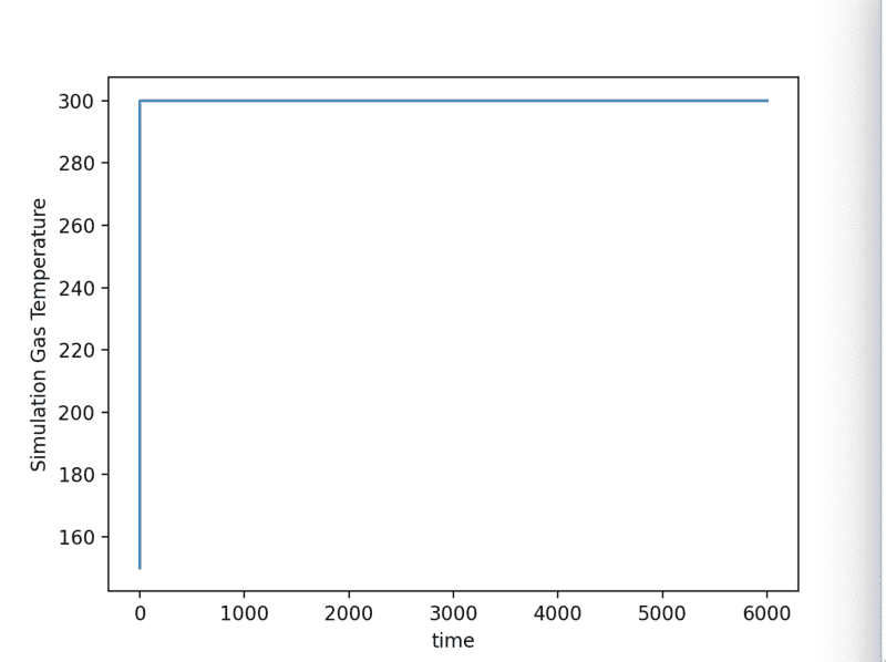

Ah ok interesting so I ran that model for the single tank and multi tank (3 tank) scripts. Here's the gas temperature output for both.
Single tank:
3 tank:
Notes:
1) The script will run for any time span. With the non zero mass transfer coefficients it 'broke' at about 600s
2) The temperature trends look generally as expected. The single tank script almost exactly matches the first tank in the multi tank script (not exactly but close)

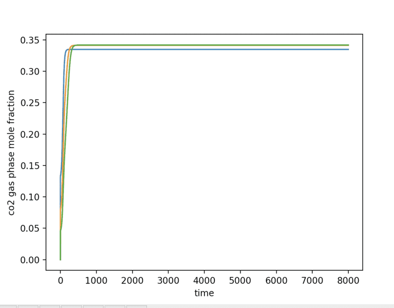

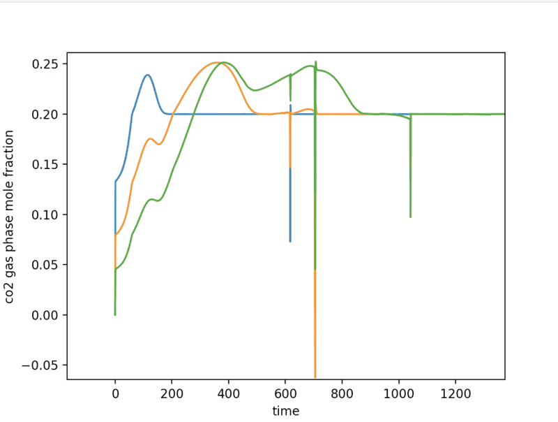

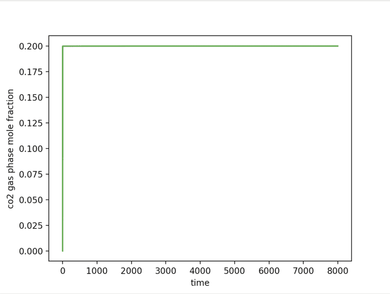

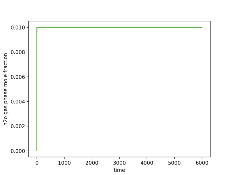

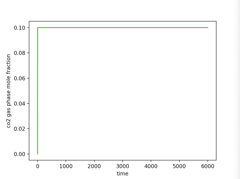

The gas phase mole fractions for H2O and CO2:
Notes:
1) 0.1 and 0.01 are the inlet mole fractions of CO2 and h2o respectively, so this plot shape makes sense (with non constant heat transfer coefficients the CO2 fraction weirdly went up to 0.15)
2) The rise to the inlet conditions is almost immediate. I'm not sure if this is expected, or if this would take time. I guess an immediate jump seems reasonable though since we're effectively flushing the bed?
Do these plots seem reasonable to you?
This does narrow it down to the mass transfer coefficient related variables that are causing the script to break. And more specifically it might be the liquefaction/sublimation pressure equations as an initial guess
Also, do you know of another simplification I can make (besides mass transfer coefficient = 0) that would possibly uncover some useful information?
Edit: No, just thinking about the mole fraction graph some more, I don't think this graph makes sense. Hmm so upstream of the frozen plug we will see the inlet conditions in the gas phase (10% co2, 1% h2o), downstream of the plug we will see 0% co2/h2o. At the exit of the bed the trend will be that there will be 0% co2/h2o present in the gas phase, except for when the plugs reach the exit, there will be a temporary spike in the gas phase mole fractions (above 10% and 1%), then it will reduce to the inlet conditions again and remain here infinitely
Notes:

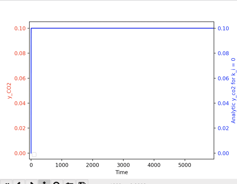

What do the mass fraction balance equations reduce to for the 1st tank with no mass transfer between phases? What is the approximate analytic solution to these equations, and does your numerical solution match these?
casualguitar said:
Oh one other question - the summation term (the last term in the gas phase mole balances), is this term the sum of the molar desublimation/liquefaction rates of CO2 and H2O?
Yes. Of course, with no mass transfer, these terms are not present.
casualguitar said:
Or say in the CO2 mole balance is it just the H2O liquefaction rate that goes in here i.e. we don't account for CO2 desublimating twice in the same equation?
No. Include both terms.
I think the approx analytic solution for the mole balance is:
$$y_{CO2} = y_{in}(1-e^{(\dot{m}t/m)})$$
where ##y_{in}## is the ##CO_2## inlet mole fraction which is ##0.1##, ##\dot{m}## is the inlet molar flow which is ##0.5mol/s## and ##m## is the molar holdup
I made a comparison plot above of the CO2 mole fraction from the simulation versus the analytic CO2 mole fraction. They are the same (the blue line is right over the red one). So that confirms the fast rise in the first tankAnd great yes I was including both terms
So this reduces the error in the 'full' model (which is constant mass transfer coefficients for now) to the parameters which use the mass transfer coefficient
Is there a way I can slightly increase the model complexity in regards to the mass transfer coefficients, without fully implementing them? In an attempt to locate what isn't working

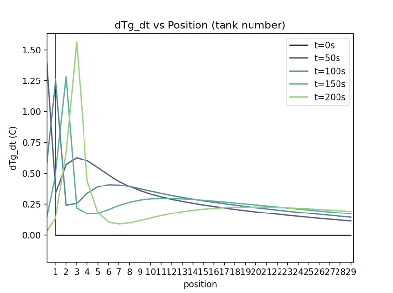

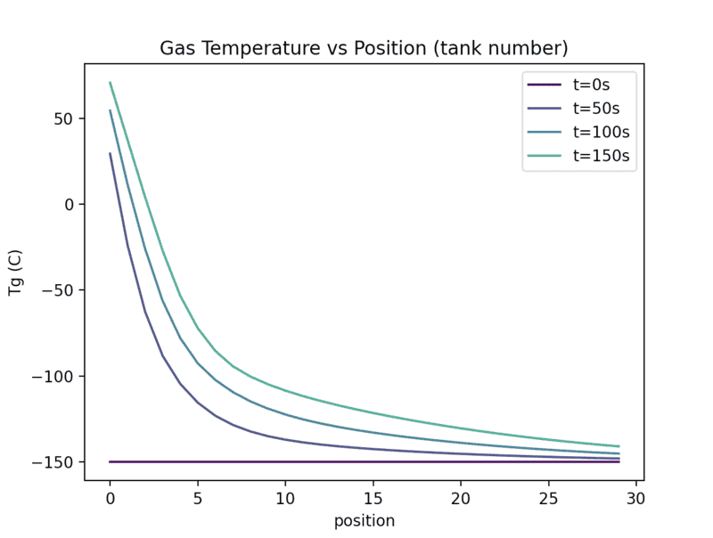

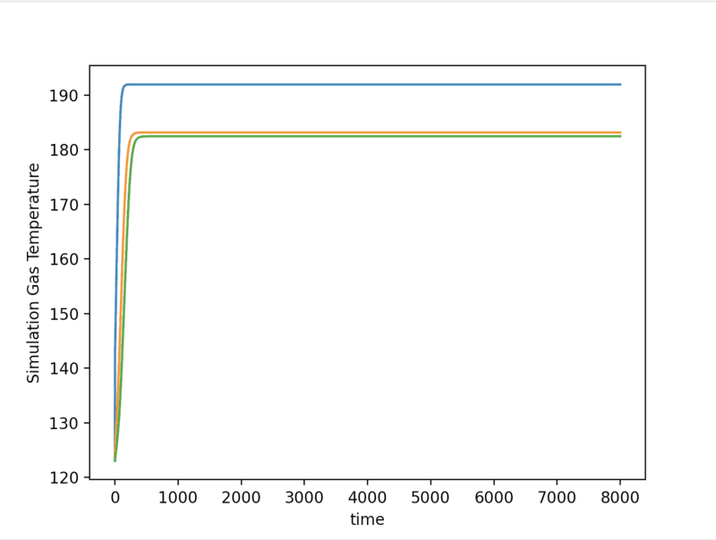

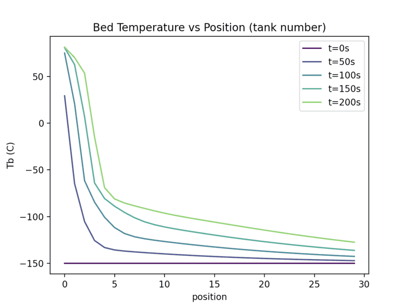

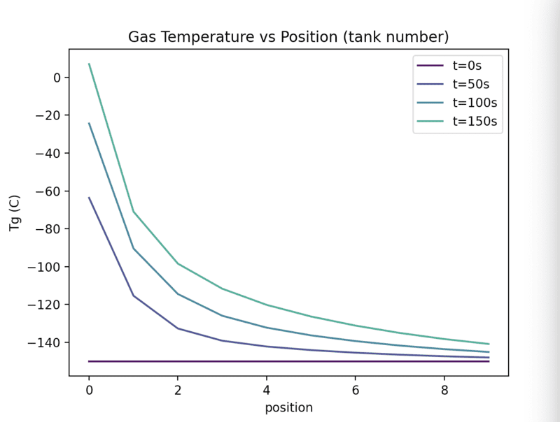

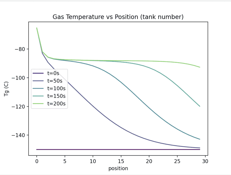

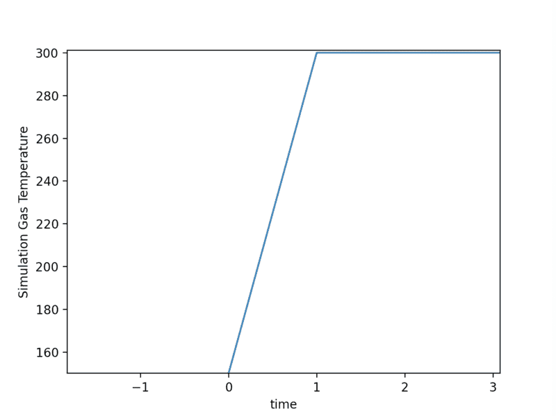

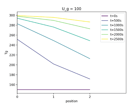

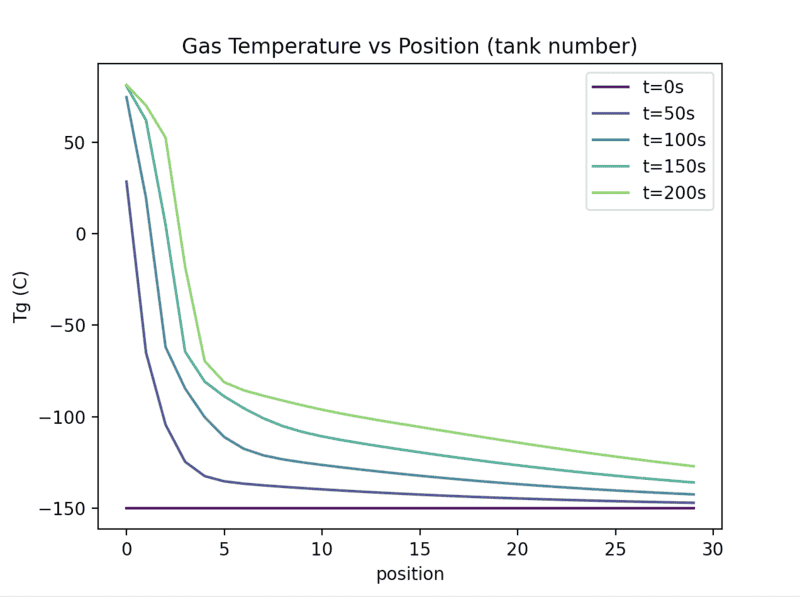

So there is a bug related to the heat transfer coefficients. I don't know what it is exactly yet though.
Position vs gas temperature for range of ##U_g## values:
Varying the gas and bed heat transfer coefficients from ##10^{-4}## up to ##10^4## has no effect on the position vs temperature (gas and bed) plots. The plot looks like this for all values of U:
Similarly when the heat transfer is suppressed (I did this by letting ##U_g## and ##U_b## equal to 0.000001, as there would be division by zero otherwise), the plot looks the same as above.

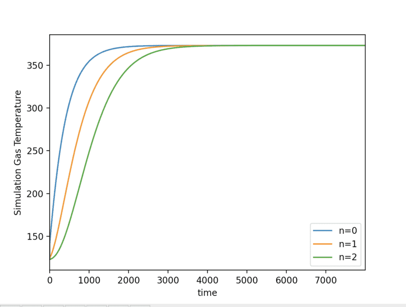

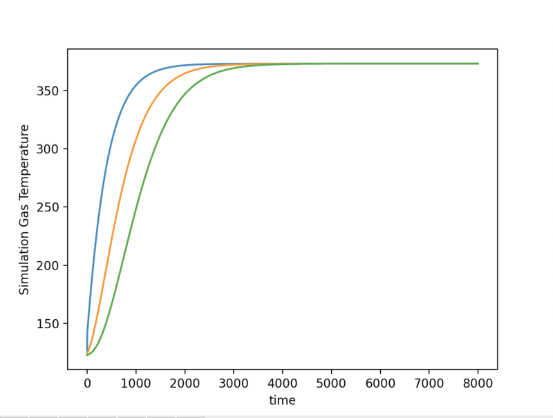

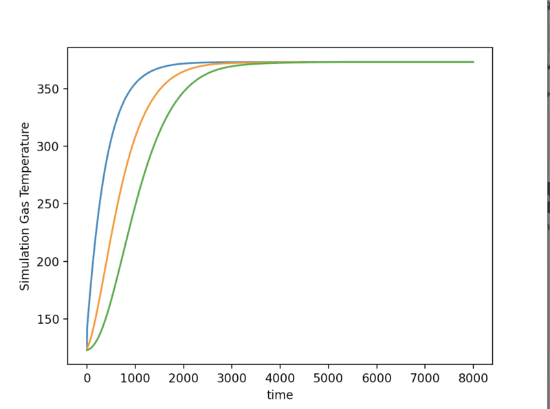

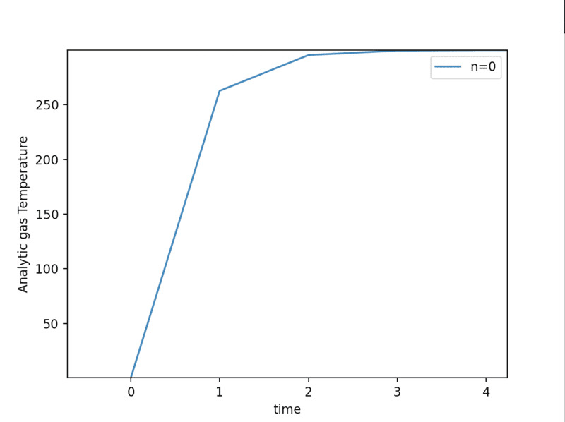

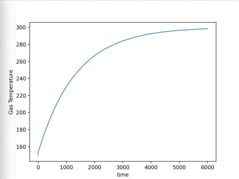

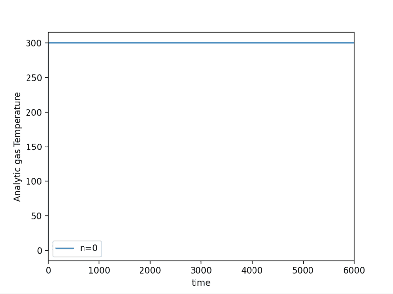

Time versus gas temperature for tank 1 (numeric vs analytic):
The analytic and numerical solutions match for HTCs set to zero. Also suggesting that adding in heat transfer terms has no effect (some error in the code)

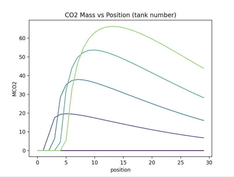

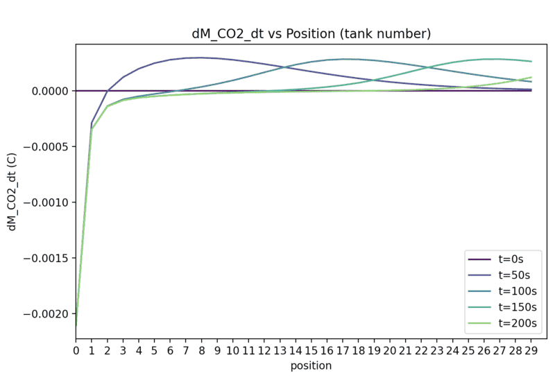

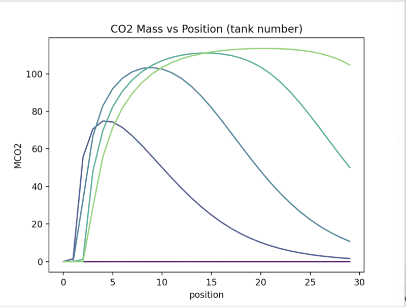

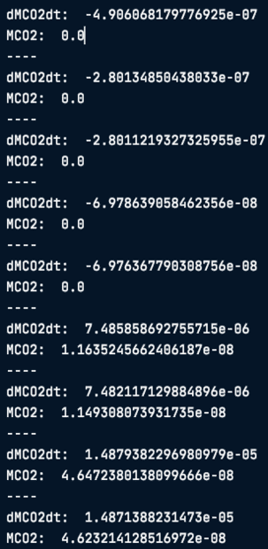

Checking the output for ##k_i## 10 and 100 times smaller:
Ok slightly interestingly here I can get normal output for ##10^{-8}##. The ##10^{-6}## value I was using before did not allow the simulation to run. However, I compare this output to the output where ##k_i## = 0 and it is the same! For both of these tests the heat transfer coefficients were a constant 100W/m2.KSo in summary, the mass and heat transfer coefficients currently have no effect on the gas or bed temperature (assuming the values used allow the simulation to finish)! I will look into this now however any thoughts appreciated as usual

Please try more, say at least 10.
casualguitar said:
Can do. So here we'd be expecting to see that the 'sharp' temperature gradient happens earlier with with increased values of gas heat transfer coefficient (htc)
If you are talking about spatial position, increasing U should bring the bed and gas temperatures much closer together and make the temperature wave travel more slowly through the bed.
casualguitar said:
So we would have ##U_g## and ##U_b## = 0 here. Are we assuming the mass transfer coefficient is also turned off at this point?
Yes.
casualguitar said:
Also, that ##q_{g,I}## = 0. If so, the analytical solution will have the same format as the one from earlier for gas phase mole fraction
Yes. But please expand the scale so that we can see what is happening in more detail at short times.
casualguitar said:
Can doUnderstood
So in summary the tests are:
1) Tank number vs gas/bed temperature (for ##k_i## = 0 and a wide range of ##U_g## values)
2) Tank number vs gas temperature (for ##k_i##,##U_g##,##U_b## = 0)
ki =0
casualguitar said:
3) Time vs gas temperature (numeric and analytical solution comparisons for t<1000)
Yes.
casualguitar said:
4) Check output for ##k_i## 10 and 100 times smaller
5) Replicate Tuinier et al model
I'll start on these now

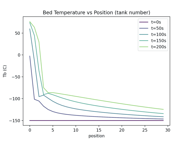

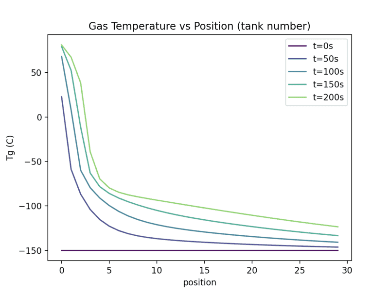

Maybe Ug is not high enough. What is the bed temperature doing?
The analytic and numerical solutions match for HTCs set to zero. Also suggesting that adding in heat transfer terms has no effect (some error in the code)View attachment 303209
I can't see the comparison on this scale. Spread out the time axis.
Agreed yes. Actually I retested it with much more values (rather than just extreme values) and I did find something. So the gas and bed temperature plots are unchanging (or unchanging to my eye at least) at about Ug = Ub = 10 and above i.e. below this value the plot changes with changing U, and there is no difference between U = 10 and U = 1000
Here is the analytical vs numerical time vs temperature plot for tank 1 at short times:
So they are not completely identical. The simulation takes 1 second to reach max temperature and the analytical solution takes 3 seconds (assuming heat transfer coefficients are almost zero and mass transfer coefficients are equal to zero). However they are technically not exactly the same. In that the analytic solution uses a constant mass holdup whereas the simulation mass holdup varies very slightly. Is this significant?
So in summary it seems that the gas and bed temperatures are limited by the heat transfer coefficients up to about U=10 (for the other simulation values), and after that increases in U (##U_g## or ##U_b##) do not affect gas or bed temperature. Is this reasonable?
Also this value of 10 is obviously affected by the other simulation values so this does not necessarily mean that U would be approx 10 in the final simulation
Just as a side note here's a plot of time vs gas temperature for n=10. The CO2 simulation has been much faster to run than the air liquefaction one. I guess the thermo library really slows it down. I'll look into shaving off thermo uses where possible in the other model
EDIT: And just one last (important) update. So when the heat transfer coefficients are brought down to below 100 (its not really 10 but somewhere below 50 I guess), then both the heat and mass transfer coefficients start affecting the output (gas/bed temperature etc). So what seems to have happened is that the previously high U values I had were dominating any other effects.
You should be able to calculate the U value for the bed from the geometry of the particles and the volume fraction particles. Hold this constant, and vary the U of the gas. As you increase the U of the gas, does the bed temperature approach the gas temperature (no mass transfer)? At very high U of the gas, the heat transfer is dominated by the bed resistance. So the temperature profiles should stop changing with increased Ug.
View attachment 303214View attachment 303213
Do whatever it takes in the numerical model to make them exactly comparable.
Yes exactly this happens. So the bed temperature approaches the gas temperature as ##U_g## increases. And then yes above a certain value of ##U_g## (seems to be ##U_g## = 50W/m2.k or so), the temperature profile stops changing with ##U_g##.
