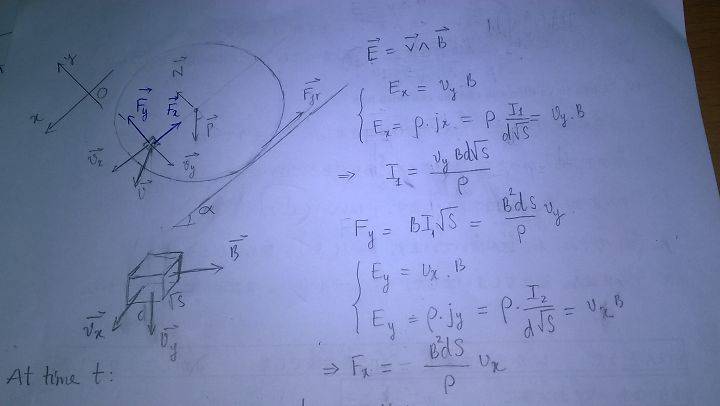

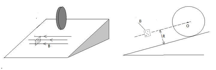

At the height h, from the top of inclined plane forming an angle α with the horizontal, a disk slips down which has radius R, thickness d, mass m and resistivity ρ. On inclined plane, an area S is very small square that has a magnetic field B. The magnetic field B is directed horizontally, intensity is constant, at distance R from surface of inclined plane (figure)
Find the velocity of center of mass at time when the disk leaves the magnetic area. Suppose that the disk rolls without slide
Newton's law: F=ma $$\vec{E}=\vec{v}×\vec{B}$$
Current density $$\vec{j}=\frac{I(\vec{l}\vec{n})}{S}\vec{n}$$ with \vec{l} is vector unit alongs electric current
Differential form of Ohm's law: $$\vec{E}=ρ\vec{j}$$
Force is appeared by magnetic field, along x-axis and y-axis are relational. Althought I can write Newton's law but I can't find the velocity

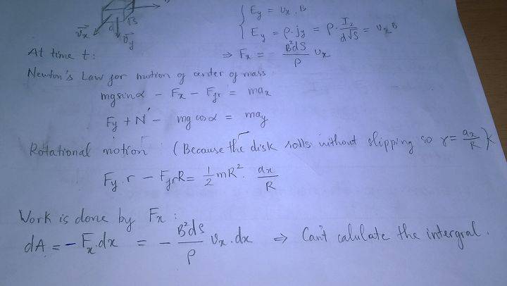

I thinked that using kinetic energy theorem. ΔW=ΣA
But I can't find the work of the x-axis is create by Fx (electromagnetism force). Because while disk rolls, the area S moves too. And size of velocity of area S isn't constant. It is relational with the velocity of disk. So equations differential is very difficult.

Ok, so the retarding force is some constant k times the normal velocity. That's what I needed to know.
If x is the displacement of the disc down the slope, with x=-r representing the point at which the leading edge reaches the field, I get
##I\ddot x=A-k\dot x(x^2+r^2)##, for some constants A and I.
We can integrate that directly, or convert to the time-independent form using ##\dot v= v dv/dx##, but neither produces anything I can see how to solve.

That's a tough problem, and it's not completely clear to me what's given. First of all is the disk slipping or rolling (from the text it says it's slipping), and I guess one should neglect friction.
Qualitatively what happens when the disk, supposed it's a conductor, enters the magnetic field due to the Lorentz force on the conduction charges (in metals electrons) you get a charge separation and an electric field builds up, and this electric field causes a current and dissipation through the resistance of the conductor. So you have to calculate this energy loss. It's not totally clear to me yet, how to do that with the full dynamics, but perhaps it's a good approximation to assume that the Hall voltage and also the velocity of the disc is constant during it is within the magnetic field with the argument that the region where the magnetic field is different from 0 is small.

I seem to get a slightly different differential equation ##\alpha\ddot x=\beta-\gamma\dot x ((x-R)^2+\delta)##
I took moments about the point of contact (so I=3mr2/2). If the retarding force is F its moment is ##F\sqrt{x^2+r^2}##. The linear velocity of the disc centre is ##\dot x##, so the angular velocity is ##\dot x/r##, and the velocity of the patch of disc in the magnetic field is ##\frac {\dot x}{r}\sqrt{x^2+r^2}##. Thus the moment of F is ##k\frac{\dot x}r(x^2+r^2)##.
There are two forces, ##F_x## and ##F_y##, do you take both force's moments? Also don't understand the expression for moment , is r the radius of disk R or it is something else?
Mine equation is from ##(\sum{F})_x=m\ddot x## where I replace the friction force using the equation of rotational motion that Hamal gives in his hand writing.
