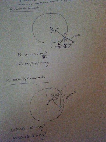

This is the diagram I have for both cases. How is the horizontal component mg sin(theta) = -m dv/dt?
And in the second case, how is the horizontal component mg sin(theta) = m dv/dt?
We don't even know which direction v is in? It's not specified whether it's going upwards or coming downwards??

If for R being radially inwards they mean that, for example, you have an object tied to the bottom of a string and you leave it hanging as it is then start to move it at an angle from the bottom upwards then it's actually working against gravity so it's going to oppose the horizontal component of weight which is trying to bring it back downwards. In case two you reverse the orientation so that the object is now at the top and you let it go from there. That way it is not opposing gravity and actually in the direction of the horizontal component of weight? I don't know.
Anyone?
I think if we use Newton's second law in the case of R being radially inwards, Σ Fy = mv^2/r and ΣFx= ma
In the case of R being radially inwards, work is being done against gravity so the only x-component present is mg sin (theta) so it will equal -m dv/dt
and vice versa for R being radially outwards.

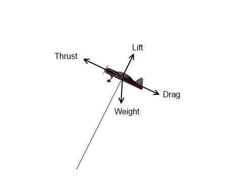

I think the original statement is badly worded. To move in a circle there must be a net centripetal force acting inwards but there can be forces acting in lots of different directions. Consider an aircraft performing consecutive outside loops. We usually consider that there are four forces acting on the aircraft... Lift, Drag, Thrust and Weight. In order to move in a circle they must have a centripetal component = mv2/r.
Have a think about the Lift force at the very top of the outside loop. At that point the lift force can still be upwards (outwards) but it must be less than the weight if the aircraft is going to descend into another loop.
Thank you for your reply. That made is very clear but I just have one concern, can you take a look at the example picture I posted right before your post? How did they decide the reaction force of the wire on the bead was going to be radially inward? And then they later got both forces for inward and outward?
PS: A lot depends on the speed of the aircraft. If the aircraft is very slow then at the top the lift force can be outwards (otherwise gravity would provide too much centripetal force). If the aircraft is a very fast jet then it might need to be inwards (gravity alone being unable to provide the required centripetal force).
