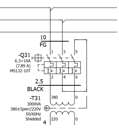

Why we use such connection between 4 and 5 terminals? Why the transformer isn't connected via 2 and 4 terminals from CB, the voltage will still be 380V because it's between two phases? In such situation the terminals 5 and 6 will stay unused, why not on this way?
  • Circuit schematic of a three-pole motor circuit breaker -Q31 (MS132-10T, 6.3 to 10A) feeding a -T31 3000VA transformer with 380V input and 220V output, with terminals 1 to 6 labelled and busbars marked 10 FG, 2.5 BLACK and 4.

Most 3-phase overload relays requires current on all 3 legs. This wiring method provides that.
