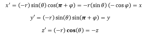

My central problem still remains, but now I can state it more succinctly.
Using the conversion above, I get
Unless I have made some mistakes, this again does not end up with the original point. So I remain confused. Where am I going wrong?

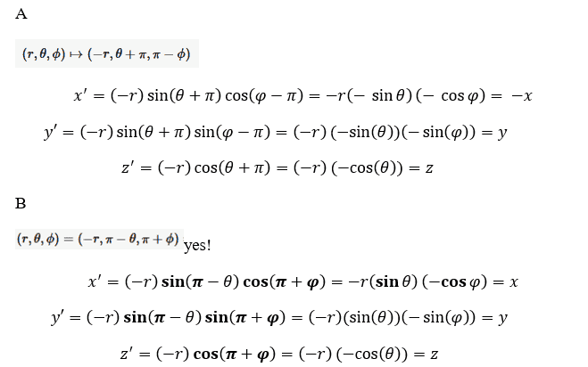

Thanks, Hill. You are right, I have made some elementary mistakes. Mainly misplaced negativee signs. But I am still a bit at a loss.
My first mistake was to trust this answer:
https://math.stackexchange.com/ques...-r-be-negative-in-spherical-coordinate-system

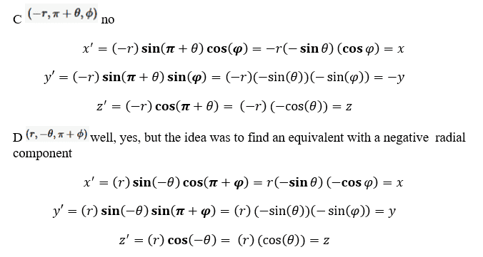

So, backing up, and using Wiki to put the two together
( r , θ , φ )≡ (− r , θ , φ+π)
But then I still seem to be making mistakes, but I am not sure where:

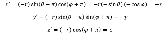

Thanks, anuttarasammyak. I'm not sure your version works either

Out of the four suggestions of Hill and pasmith, I get one which is suitable. The calculations:
So, unless I have made an error in my calculations (always possible), I think I have the solution to my problem. Thanks for all the patience on the part of all!
I think that C is also "yes":
##y'=(-r)sin(\pi +\theta)sin(\phi)=(-r)(-sin(\theta))sin(\phi)=y##.
Oops! Thanks very much, Hill. I don't know how that extra negative got in there. So, wonderful bonus!
