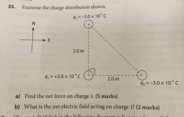

Examine the charge distribution shown.
b) What is the net electric field acting on charge 1?
I used the equation E= (kq1/r^2) + (kq2/r^2)
I subbed 9.0 x 10^9 in for k, 3.0 x 10^-5 for both q1 and q2, and 2m for r.
My final answer was 135000N/C
Just want to check if my answer is right or if I'm messing something up. Thanks

a very important detail is that the electric field is a vector field. you have to solve this by components, and use the Pythagorean theorem to find the magnitude and direction of the field.

The forces acting on q1 are due to the fields emanating from q2 and q3 separately! thanks to superposition, the net force is just the (vector) sum of the two.
lucky for you, the question is set up so that the fields at q1 are orthogonal to each other.
so calculate each one separately, and the use the pythagorean theorem to find the magnitude and direction.

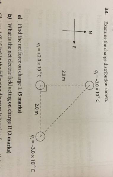

ehild said:
The charges q2 and q3 are given, you have to find the electric forces due to q2 and q3. How do you calculate them? In what units?

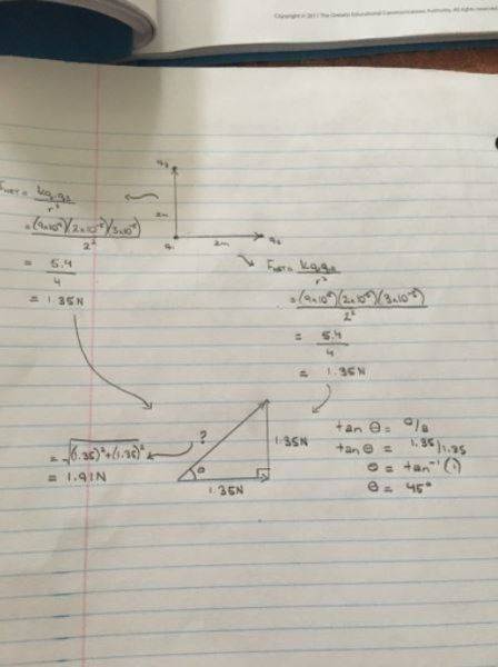

Okay, I decided to just write it all out on paper so I can show what I'm doing. Is this correct?

This is correct.

I was wondering if the vector arrows I drew are in the right direction? Should the vectors be acting on q1 instead?
Also, for the first part, it asks for the net force acting on charge 1. Isn't what I sent a photo of answer the first part of the question. I saw on another website that to find the net electric field, I have to take the net force and divide it by q1 to get a final answer in N/C. Is this right?
They are correct. opposite charges attract, so q1 is feeling an attraction force, being pulled towards q2 and q3, so the arrows representing the force should also be pointed towards q2 and q3.
