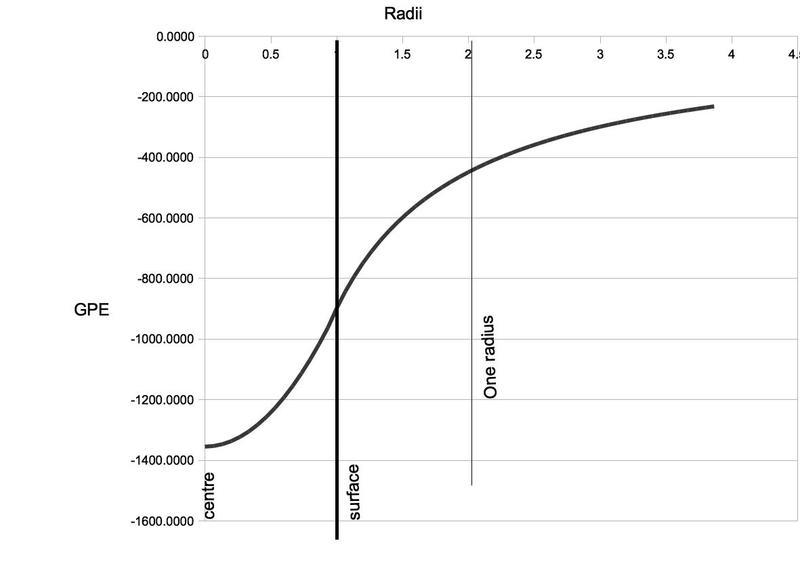

3. The object is in a thin tube through the centre of an otherwise solid Earth.
It will observe that it exhibits simple harmonic motion - demonstrating that the force towards the centre is proportional to its distance away from the centre.
  • #83
So then gravity gets larger as you go away from the center of the earth? When you hit the surface gravity gets smaller as you go away from surface.

It's not just the size it's really the density that determines gravitational force. You could have a large planet made out of a low density material and it's gravity would be much smaller than a very small planet made out if say plutonium a very dense material. The
Smaller planet would have a greater gravitational pull.
But the idea that gravity gets smaller once you move from the surface in either direction (towards space or towards the center) doesn't make sense. Gravity pulls toward the center of a mass. If you are beneath the surface it makes sense for gravity to pull the same or more. Not less
  • #87
Dear Sophiecentaur,
if you weigh yourself on the top of Mount Everest, not leaving the surface of the earth, guess what! you would weigh a little less that at sea level.
  • #88
So if you were to move an object thousands of miles into space, you think the gravitational pull would be the same?
As far as what happens when you go below the surface, you actually need to do the calculation. For the simplified case of a uniform density spherical planet, the gravitational field varies linearly from 0 at the center to its full value at the surface. (And I hope it's obvious that as you keep going above the surface, the gravitational field gets smaller.)
  • #89
A summary of what I've seen posted.
Although gravity is zero at the center of the earth, pressure will be greatest at the center of the Earth unless there is some solid shell surrounding the center of the Earth that is supporting some or all of the weight outside that shell, in which case the pressure inside the shell could be anything.
If there is a shell supporting all the weight outside the shell, and the inside of the shell is a vacuum, then depending on the Earth's mass distribution (such as a uniform sphere, or a sphere made of continuous uniform spherical shells), there would be no gravity at any point within that hollow shell.
If an object were placed inside inside the hollow shell with zero gravity, then the object would create it's own gravitation field. I'm not sure about interaction between the object and the mass outside the shell, other than the object's gravitational field would increase the pressure on the shell.
  • #90
Is the core of the Earth less dense than the outer layers? if the core is less dense then the gravity field would be less. If the core were more dense then the gravity field would be greater. If the same density then the same.
If there was a person who was placed inbetween two large but symmetrically opposing g forces they would not move . But they would experience a greater field of gravitation compared to being weightless in outer space far away form any masses.
Gravity does not cancel itself out to zero.
so if you are in the middle of the Earth you experience a different g field than in the middle of space with no masses around you.
