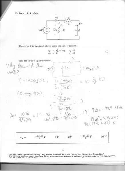

See figure
Again, see figure I tried something and it looked promising but the answer doesn't work out.
Any ideas?
Could you explain your reasoning to get the equation
[tex]\frac{1+v_Q/i_Q}{2+v_Q/i_Q} = 10[/tex]
I don't see how you're applying Kirchoff's voltage law to get that.

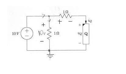

You know the 1 ohm resistor is in parallel with the 10V source, therefore the voltage across it is 10V. Now we can subtract from the 10V the drop across the other 1 ohm resistor which is 1*Iq, and subtract Vq. 10 - 1*Iq - Vq=0, we can plug in for Iq which is Vq^2+2*Vq. Solve for Vq, you'll obtain a positive and negative value but only the positive makes sense because of our polarity.

When you combine the circuit resistances, first by adding the two in series, and then by calculating the two in parallel, you get a value of resistance (keep in mind SI units).
In your equations you say this resistance is equal to 10 volts by KVL.
Resistance does not equal voltage.
Thanks for the responses. I must have been out of it at the time putting resistance equal to voltage lol.
I understand now.
[tex] V_{q} = 2V [/tex]
