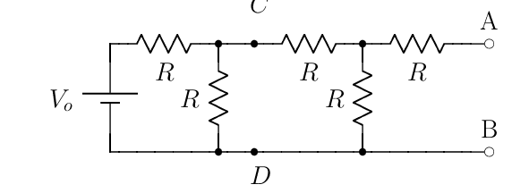

Find the open circuit voltage across A & B:
Circuit schematic: battery V_o on the left feeds a resistor ladder of four R resistors, with nodes C and D marked and open terminals A and B on the right.
V = IR
If I0 is the current leaving the voltage source and passing through the first resistor, I1 is the current through the left resistor in parallel, and I2 through the two other resistors, then:
[tex]V - I_0 R - I_1 R = 0[/tex]
[tex]-2 I_2 R + I_1 R = 0[/tex]
[tex]I_0 = I_1 + I_2[/tex]
Solving gives a current [tex]I_2 = \frac{2 V}{5R}[/tex], therefore the potential difference across the A & B terminals is [tex]\Delta V = I_2 R = \frac{2 V}{5}[/tex]
The book says this is [tex]\frac{V}{5}[tex].<br /> <br /> Am I doing something wrong, or have I found an error in the book?[/tex][/tex]
You made an error while solving the equations. You can see this if you try to find all the currents: If I_2 = 2V/5R then I_1 is 4V/5R and I_0 wil be 6V/5R, but this means that the leftmost resistance has a potential difference of 1.2 V_0 across it, which is impossible.
This problem is easier to solve if you compute the thevenin equivalent of the circuit to the left of C and D first. It will also be useful when you have to compute the short circuit current of the entire circuit.
Yep, that's the case. I must have plugged it into Mathematica wrong.
