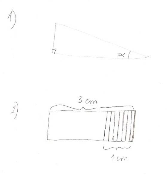

See pictures for the data.
Basically there's a transparent prism looking like an inclined plane and making an angle [tex]\alpha[/tex] with the horizontal. Its base is 3 cm large and if we shine a vertical light of wavelength [tex]\lambda[/tex], we can observe an interference pattern as seen in the figure. If the interference pattern is 1 cm large, what is [tex]\alpha[/tex] worth?
Give the intensity of light in the interference pattern.
Figure out why do we only see an interference pattern in 1 cm despite shining light over the whole prism.
No idea.
I've absolutely no idea how to start this. In fact I don't understand where the interference pattern is (can we see it because of a diffusion somewhere in the prism?!). Is it at the base of the prism? Why is there interference?!
I know there's refraction of light through the inclined surface and then there's a reflection (Changing the phase of [tex]\pm \pi[/tex] rad or not? I know reflection causes a change in angle's phase, but in this case it's internal reflection so [tex]n_i=n_f[/tex] and I've read that for a change of phase in reflection, the transmitted material must have a higher refractive index than the incident one, which isn't the case in this exercise!).
I'm totally troubled and fail to understand what the heck is going on in this interesting exercise. Any help is greatly appreciated.
More details about the pic: I do not see any difference of intensity in any of the fringes of interference and they are equally distanced. Which lead me to think that the interference does not occur of the surface of the prism but I might be wrong. And sincerely I've never heard of such an interference where there's no difference of intensity in all fringes and suddenly the interference "stops" at a certain place. This problem was in my optics exam that I miserably failed.
P.S.: the direction of the rays in the sketch 1) is vertical. In 2), it wasn't indicated (hence my enormous confusion of where we see the interference!) but I'm guessing the rays should enter the page.

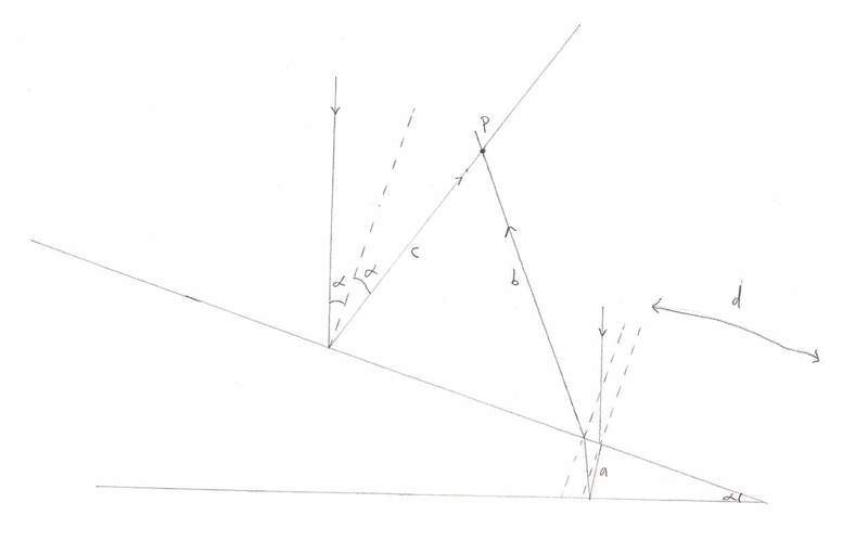

I've tried to redo the exercise. I've considered a point P, the observer point.
I've drew 2 rays reaching point P. One is a ray that has been reflected over the surface of the prism. The other is a ray that entered the prism (refracted), reflected over the internal surface of the prism (no change in phase) and refracted again when leaving the prism to reach the air and point P.
I've drew "a" and "d", sides of a triangle.
If I consider [tex]\alpha \approx 0[/tex] then [tex]a\approx \alpha d[/tex]. The optical path taken by the ray inside the prism is thus approximately equal to [tex]2 n_2 \alpha d[/tex] where [tex]n_2[/tex] is the refractive index of the prism's material.
If I consider [tex]b \approx c[/tex] (compared to the wavelength... I'm not sure I can do this approximation).
The total electric field reaching point P of these 2 rays would be [tex]\vec E = \vec E_0 [\cos (\omega t \pm \pi)+\cos (\omega t + 2 k_2 n_2 \alpha d)][/tex]. If I fix time to [tex]t=0[/tex], I get the condition [tex]\frac{n_2 \alpha d}{\lambda}=2 \pi m[/tex] where [tex]m \in \mathbb{Z}[/tex]. I could isolate [tex]\alpha[/tex] and set d=2cm in order to get the answer to the question
If the interference pattern is 1 cm large, what is [tex]alpha[/tex] worth?
but this does not convinces me at all. What would be m?!
Further I'm not even dealing with intensity but with electric fields. I know that the intensity is related to the electric field (the square of it and averaged over a full period according to Hecht and it multiplied by its complex conjugate according to my professor. I'm really confused about how to get the intensity, if you could clarify a little bit I'd be glad) but I'm not sure how exactly.
What do you think about what I've thought?

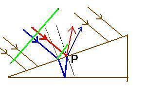

You can consider the incoming light beam as a bunch of parallel light rays. The rays are normal to the wavefronts of the incoming wave (green lines). Wavefront means a plane where the electromagnetic field is the same at every point.
Choose a ray (the blue one) which represents a wavelet, part of the incoming beam. Part of this wavelet is reflected from the surface, the other part enters into the prism, is refracted, reaches the back surface, reflects from there than reaches the front surfaces, and part of it leaves the prism at point P. There is an other ray (red) which reaches the wedge at the same point and is directly reflected. These two reflected wavelets do not travel quite parallel, but almost, and they make a common wavelet. The intensity depends on the phase difference and this is determined by the difference of lengths both rays travel from their last common wavefront to point P. You get similar pair of interfering wavelets all over the wedge. At some points, the phase difference of the outgoing wavelets is odd multiple of pi, you see a dark strip at that point. At other points, there is constructive interference between them.
(The statement that the beams are nearly parallel so they can interfere is a bit oversimplification. But the light beams are always a bit conical, even the laser beams. So those rays in the figure are really cones of rays and they contain wavelets which are really parallel.) ehild

Little question regarding your sketch. If alpha is small, can I neglect the optical path of the red ray starting with the second intersection of the green ray and up to the point when it reaches the prism? If yes then the optical path difference would be only n2 times the distance the blue ray travel into the prism. However I'm not sure I can neglect the small path of the red ray.
Almost same question, if alpha is small, can I say that the incoming and reflected blue ray inside the prism travel the same optical path before leaving the prism?
Last question: If the incoming rays are vertical, we get no interference because the refracted+reflected+refracted rays leave the prism in an opposite direction compared to the reflected rays, right? Their [tex]\vec k[/tex] is too different to talk of an interference. Am I understanding well?
The angle of this wedge is usually very small in order to get interference. You never see interference strips on a common prism, do you? If the angle is very small, the incident light can be nearly vertical, but even then it should come from the left with respect to the wedge normal.
The green lines in my drawing are wavefronts. You have to count the path traveled by the rays from their intersection point with the last common wavefront. The blue ray traveled the blue line inside the prism, you have to multiply this length by the refractive index of the prism, (n2) to get the optical path. The red line traveled in air between the intersection with the green wavefront to point P where it hit the wedge. You can not ignore this piece in general. If the light hits the wedge along the normal, then the surface is a wavefront and the small piece of the red line disappears. But even this normal incidence is not favourable for interference.
If the angle of the wedge is very small, and the incidence is nearly normal, the optical path difference between the blue and red rays is about 2n2d. Otherwise the two pieces of the path are different. See the derivation in the paper I sent. It is always better to derive something exactly and then find the limit case.
This wedge problem is usually treated in such a way that the rays are drawn vertical, both in air and in the prism, (neglecting all laws of reflexion and refraction), and the path difference is said to be 2nd, d = x sin(alpha) where x is the distance of P from the edge of the prism. ehild
