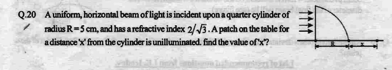

(see attachment)
I don't quite understand the question. It asks the distance of the "unilluminated patch" from the cylinder. There will be only a single point where the rays will intersect. Rest everywhere, it is unilluminated or am I missing something?
Any help is appreciated. Thanks!
Hi Pranav-Arora! :smile:
Hint: critical angle. :wink:
Thanks a lot tiny-tim! That solved the problem in an instant. :smile:
