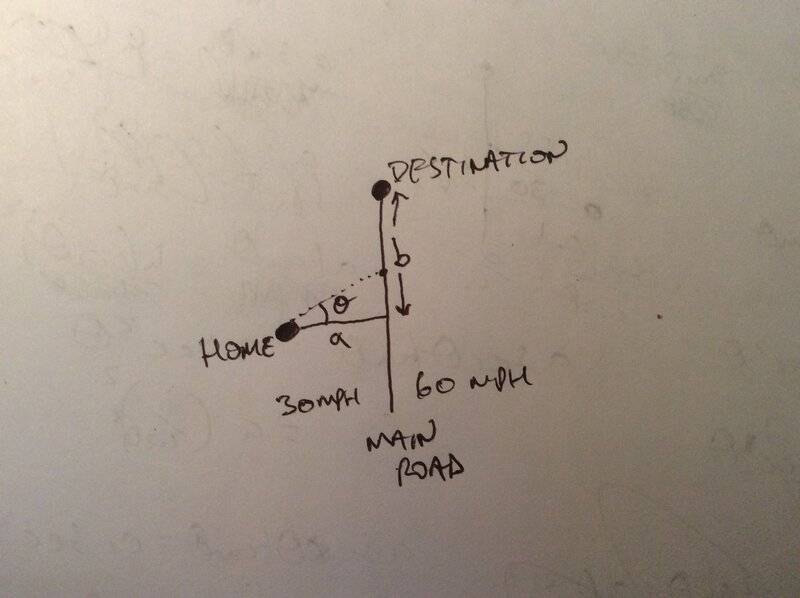

A simple problem I found, while looking for calculus practice. Roads between home and main road are 30 mph, main road is 60mph:
What is the optimum ## \theta ## to minimise journey time?
## t = \frac {distance} {speed} ##, so is a combination of the hypotenuse, and the fixed distance b minus the opposite side of the triangle formed.
In terms of ## \theta ##:
## t = \frac a {30\cos\theta} + \frac {b-atan\theta} {60} ##
## \frac {dt} {d\theta} = \frac 1 {30} asec\theta tan\theta - \frac 1 {60}{asec^2\theta} ##
Set ## \frac {dt} {d\theta} ## to zero:
$$ \frac 1 {30} asec\theta tan\theta = \frac 1 {60} asec^2\theta $$
Multiply both sides by 60:
$$ 2asec\theta tan\theta = asec^2\theta $$
Divide by a:
$$ 2sec\theta tan\theta = sec^2\theta $$
Divide by ## sec\theta ##:
$$ 2tan\theta = sec\theta $$
Alternatively:
$$ \frac {2sin\theta} {cos\theta} = \frac 1 {cos\theta} $$
Multiply by ## cos\theta ##:
$$ 2sin\theta = 1 $$
$$ sin\theta = \frac 1 2 $$
$$ \theta = sin^{-1} \frac 1 2 $$
$$ \theta = 30\deg $$
And, although I’ve been puzzling over this for over an hour, in setting out the question here, I’ve got an answer. Is it correct?

I’m sorry, I don’t understand the question. Are you allowed to travel diagonally (that is to say not on the roads)?
Are you saying we can travel diagonally with a horizontal component no greater than 30 mph and a vertical component no greater than 60 mph?
Likes Delta2
The original question, from Gilbert Strang’s lecture series on the basics of calculus, imagined a network of 30mph roads between home and the main road.
I think the idea was to work out the optimum angle to aim for. This on the understanding that in the real world, you’d have to plan a ‘best fit’ route with the available roads.
In his lecture, he calculated minimum ## t ## with respect to a joining point ## x ##, such that the diagonal journey would be ## \sqrt{a^2 + x^2} ##, and the remainder of the journey simply ## b-x ##.
He then suggests trying the same scenario with respect to ## \theta ##
Likes PhDeezNutz
I got the same thing. I did things a little bit different at the end when solving for ##\theta##.
##\sec \theta = 2 \tan \theta##
##\sec^2 \theta = 4 \tan^2 \theta##
##\sec^2 \theta - \tan^2 \theta = 3 \tan^2 \theta = 1##
##3 \tan^2 \theta = 1##
##\tan \theta = \frac{1}{\sqrt{3}}##
##\theta = \frac{\pi}{6}##I like your way better. At first I was trying to set up the problem in all sorts of weird ways involving Lagrange Multipliers and whatnot...turns out that was a bad idea.
Likes Guineafowl and Delta2
Thanks for confirming that.
With your method, I’m not sure how this bit =1:
Another thing troubling me is how the fixed distances ##a## and ##b## disappear from the answer, since there will be values of both where 30° will miss the destination completely (small ##b## and large ##a##).
Likes Steve4Physics and PhDeezNutz
Can I chip in?
In the initial equation
##t = \frac a {30\cos\theta} + \frac {b-atan\theta} {60}##
there is an in-built assumption: the last term requires that ##b≥atan\theta## in order for the term to be non-negative. This requires ##tan\theta ≤\frac b a## (taking a and b as positive values).
So, in this particular problem, the solution (##\theta = 30^o##) is only valid when ##\frac b a ≥tan(30^o)##.
__________
To get ##\sec^2 \theta - \tan^2 \theta = 3 \tan^2 \theta = 1## @PhDeezNutz has used the identity ##sec^2 \theta - tan^2 \theta = 1##.
___________
On a general point, I recommend combining simple algebra steps where appropriate. So for:
##\frac 1 {30} asec\theta tan\theta = \frac 1 {60} asec^2\theta##
you can quite easily:
- multiply both sides by 60;
- cancel 'a’s on both side;
- cancel 'sec's on both sides
in a single step, going straight to:
##2tan\theta = sec\theta##
Likes PeroK and Guineafowl

Guineafowl said:
‘a question well stated is half answered’. He was certainly right in this case.
I’ve never seen this before. But it’s profound.
Have you noticed that your θ is independent of ##a## and ##b##?
Is it obvious to you that it must be?
And what actually happens when b is small enough that your θ direction from starting point would take you beyond given arrival poin?
Yes, as I say above, it’s interesting that the ##a## and ##b## terms disappear from the minimum time calculation. @Steve4Physics provided a nice explanation.The term for the vertical journey, assuming you can only travel upwards on the main road, is:
$$t = \frac {b-atan\theta} {60}$$
If ##b## is smaller than ##atan\theta##, ie you join the main road after the destination, the journey time sign becomes negative, ie backwards time travel.
