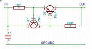

would i buy current limiters, if so what are they called, can i make them, if so how?
Well, there is a simple one here:
You can choose other circuits here:
https://www.google.dk/search?q=curr...-JbLAhUzb5oKHWmBDS0Q_AUIBygB&biw=1920&bih=946

Hesch said:
No, I'm not staying in the USA.
ok, that's fine, you have been of great help to me, just one last question, do i put the limiters on the inputs, or outputs of the buck converters?
On the outputs.
You must calculate with a voltage drop across the suggested current limiter of about 1V, using silicon transistors.
Hesch said:
On the outputs.
what do you mean?
Say you need 10V on the output of the current limiter, the buck converter must yield 11V on the output.
11V - 1V = 10V.
