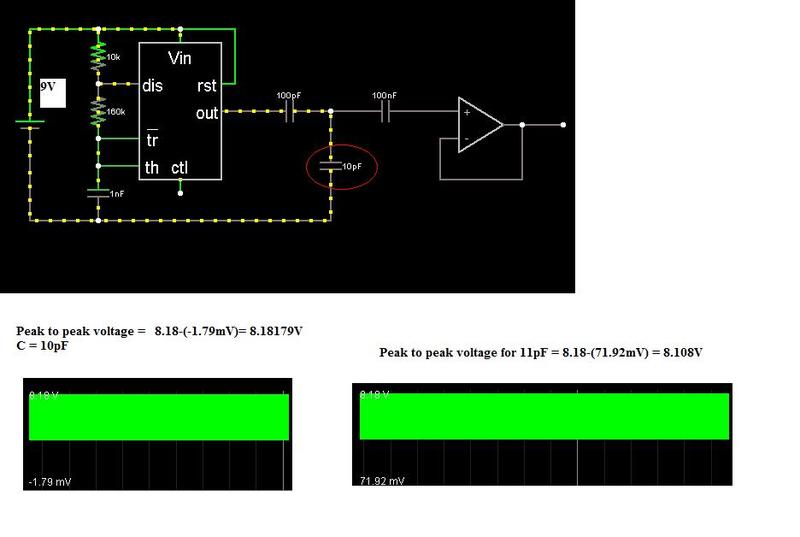

Is there a way to detect a change in peak to peak voltage and obtain this change as high or low output?? For example, to detect such a change as in attachment ( 80mV change)
  • #53
Could you draw a picture of the waveform you have and what you want to get?
I find MS Paint good for this.
If you are using Windows XP, it is available under Start/Programs/Accessories.
Show the relative DC voltages as well.
I think polystyrene foam is an excellent insulator, although it can not cope with heat or some solvents. In this case, it does not have to deal with high voltages, just provide a non-conducting space filler.

When i use a astable oscillator that produces 4Khz output and connect it to a T bridge and an Op AMplifier. I tried to use an online circuit simulator http://www.falstad.com/circuit/"
[Click Circuits on menu bar>555 timer chip > squarewave generator, chnage voltage to 9 V , add C and op Amp by right clicking the circuit"passive components and active components"]
I tried to use PSpice for simulation , but I am new to it and the simulation did not work for me.( although i created a schematic)
When i give the parameters as in figure 1 ( R1 = 10K Ohm, R2 = 160 KOHm, C = 1 nF) F is supposed to be = 4.36KHz. The waveform that is obtained at the output is shown in figure 1. For both 10pF and 11pF values. Basically they are sqaure waves.since the frequency is too high they are too crowded. If we redce the frequency one can see it.
When the C ( red marked one)= changes, the output voltage also changes accordingly.
In figure1, upper one is the circuit and the lower 2 diagrams shows the output for 10pF and 11pF. The values shown in them are the upper and lower peak values. The difference between them is the peak to peak volatge and that is waht changes when C varies.

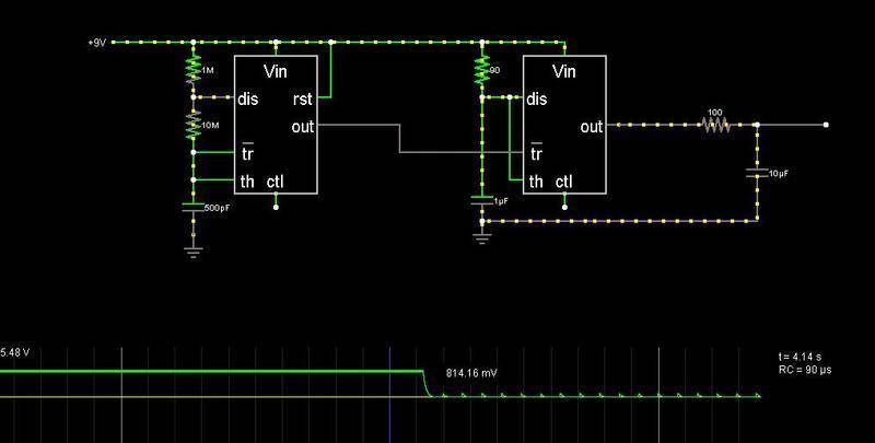

I have another question.. I saw this in another site http://www.electronicspoint.com/capacity-voltage-converter-two-555s-t33728.html"
a method by using 2 555 timers ( atable and monostable) . Can anyone explain the working of that one? I mean my C range is from 10pF to 500pF. So what frequecy output should have the astable and R& C for monostable??
Also Vk6kro: I need a bit theoretical explanation for this type of capacitance measurement. means this is not actually a parallel plate capacitor. But depends on the conductivity for change in C. am I right?? So the basic principle is "Capacitance due to conductance" or what??
  • #56
If you have a string of very short pulses and send them to a low pass filter, the output of the filter will depend on the width of the pulses or on the number of the pulses.
In this case, the number of pulses is kept constant, but the width of the pulses is varied with the capacitance.
So, this circuit works like that. The circuit should be fairly linear and it will give a greater reading for a greater capacitance.
This would be a good time to graduate to CMOS 555's though. They have many advantages and don't cost much more than ordinary 555s.

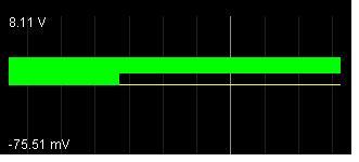

I connected an astable oscillator ( F = 5.6KHz i.e t = 0.18ms) . The output was connected to a monistable oscilator, whose F = 10KHZ i.e t = 0.1ms). It was thenconnected to an RC low pass filter.
I need a lilttel help with next part. WHen the test Capacitor changes from 10F to 500 pF the peak voltage changes from 5.48 V to 800 mV. So how can I implement a schmitt trigger to set a HIGH when voltage drops down below 5.48 V and LOW when voltage = or greater than 5.48V.? See attahcment
