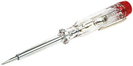

Hello Mark - I believe due to language issues, you question is not too clear.
What do you mean by tester screwdriver - a voltage detector? There are different types, can you show a picture or link to the type you are thinking of?

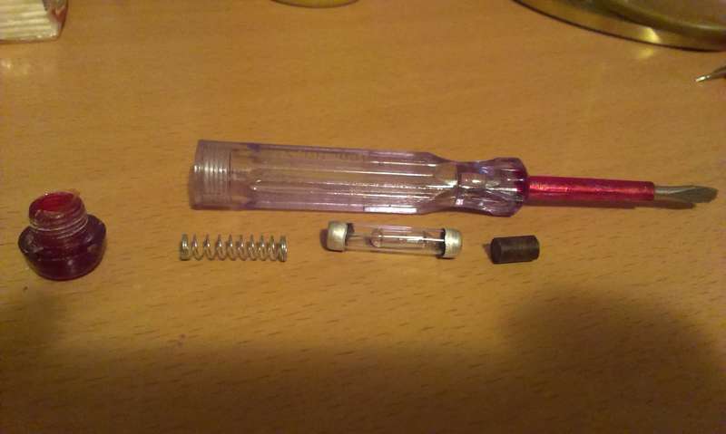

I think he means...
Using an old fashioned neon testing screwdriver the bulb lights up when it is applied to a voltage (e.g. 240V AC). My finger on the other end of the screwdriver is not (apparently) connected to ground when I am standing on a wooden floor. So how come the bulb lights up?
There is just enough current due to the capacitance of your body, or in the device, to light the neon lamp. Similarly the non-contact types use current into a capacitance to detect a time varying E field. These are so sensitive they can usually detect static generated by rubbing the device on your clothes.
