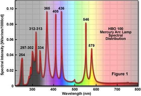

Hi everybody! I just did the photoelectric experiment this week, and I have a report to write about it. We used a mercury vapour lamp, a set of metal interference filters and a grey filter in order to find the intersection point (and therefore ##U_{g,max}## between the curves (with and without grey filter) for each wavelength as the current is changing.
The experiment went very well except for the filter ##492##nm, where the curves look kind of flat making the intersection point harder to find. Our advisor said there is an explanation that we must give in our report.
Let me know if you need more informations about the experiment. I am assuming it is a pretty standard one that many of you probably already performed, but I might be wrong.
##e \cdot U_{g,max} = h \cdot \nu - e \cdot \phi_A##
So the first thing I've done was to search for the spectral lines of mercury (see attached file), and what I found was that the peak is not very pronounced at ##492##nm. But what does that mean physically? I've googled it but could not find anything tangible yet. My guess would be that for some quantum reason I do not know, fewer electrons are released from the mercury atom at that wavelength than for others. That is still pretty vague, and maybe wrong... Any help?Thanks a lot in advance for your answers.Julien.

Have you compared your results to the spectral lines and their intensity of mercury?
Use those filters only which transmit the strong lines of mercury. The spectrum show the intensity of light mercury emits at different wavelengths. The mercury lamp does not emit electrons. The wavelengths of the peaks are determined by the change of the energy of the mercury atom between the electronic levels. The intensity is determined by the change of dipole moment during the transition. Low-intensity peaks, like at 492 nm, can be combination or overtones.

The spectrum show the intensity of light mercury emits at different wavelengths. (...) The wavelengths of the peaks are determined by the change of the energy of the mercury atom between the electronic levels. The intensity is determined by the change of dipole moment during the transition. Low-intensity peaks, like at 492 nm, can be combination or overtones.

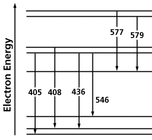

There is photon emitted at 492 nm. The photon has energy of hc/λ, which is the energy difference between the initial and final states of the mercury atom. I worked with infrared spectra, so I am not sure "combination bands" are mentioned in UV-Vis spectroscopy. The level schema of mercury is quite complicated. The emitted lines are assigned to transitions between the levels.
The figure shows the transitions between the energy levels of mercury, producing the strongest lines in the visible range.
Some transitions are allowed, some are forbidden, but even the forbidden transitions can appear with a two-step process, and then you can find that the frequency of a weak band is the sum or difference of those of two strong bands. Considering the strong lines of mercury, the frequency of the 492 nm band is close to the difference between the 254 nm band and the 546 nm band.
