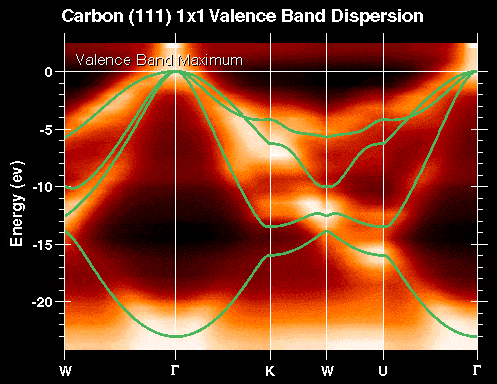

Again, you do not see any phonon effects until you actually do a rigorous analysis of the spectral function.
I am not talking about phonon effects in ARPES or about phonon scattering rates.
I am talking about the gross features of electron bands, which can be measured by ARPES. Examples are diamond and silicon, which are not free-electron like.
In the attached image file, the green lines is the theoretical band structure of diamond. There are clear gaps at zone boundaries, due to electron interaction with the lattic (Bragg reflection).
Source: http://www.als.lbl.gov/als/science/sci_archive/diamond.html

Diamond was just an example that I knew a decorative picture of. But of course one can also look at metals - nickel or vanadium or tungsten or graphite or whatever. Many bands there are not free-electron-like.
Photoemission can tell us the dispersion relations of the electrons bound in metals. I still think that this is a possible answer to the Original Poster's question. I would like to hear if he found my comment helpful.
