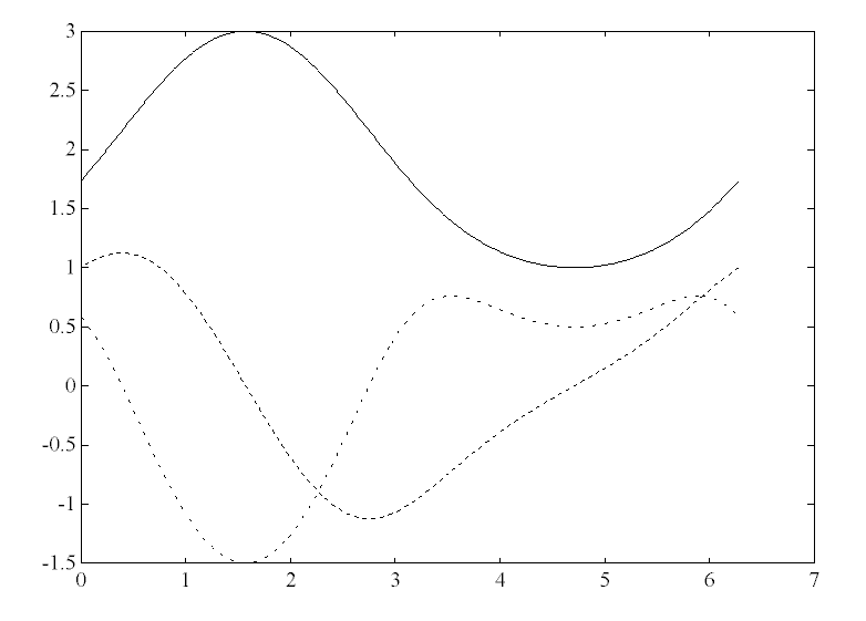

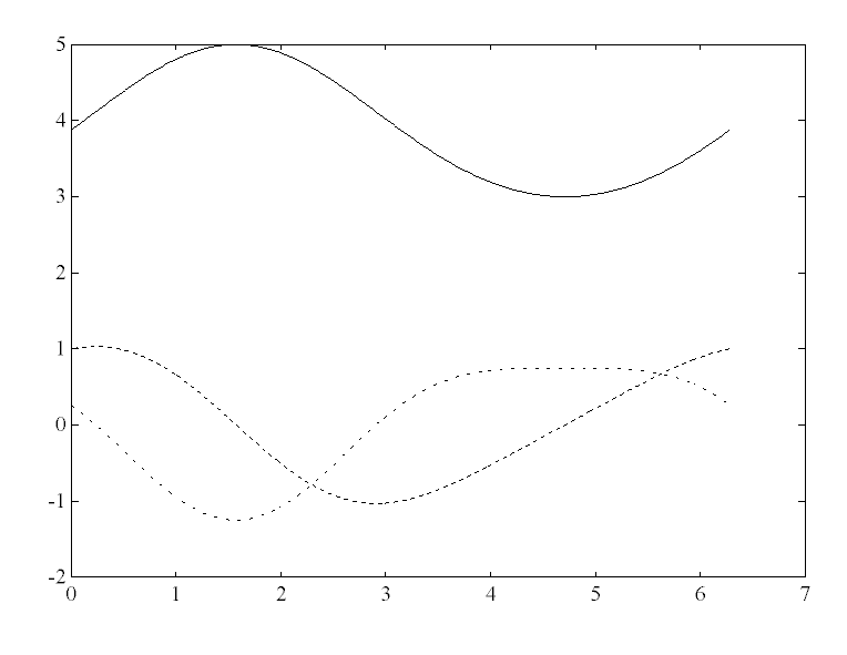

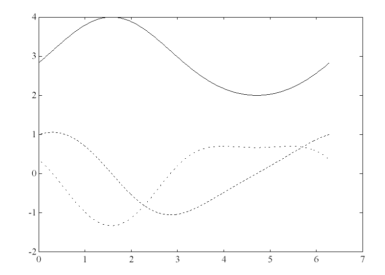

Here are the normalized values that I got for the vertical displacement (z=y/r) and it's first and second derivatives as a function of crank angle (q) and normalized connecting rod length (a=L/r). I think they're correct, though I'm sure that the expression for second derivative could be tidied up a bit. Obviously for constant crank angular velocity (omega) you just need to multiply the first derivative by omega and the second by omega^2 to get the time derivatives (by the chain rule).
z = sin(q) + sqrt( a^2 - cos^2(q) )
dz/dq = cos(q) + sin(q) cos(q) / sqrt( a^2 - cos^2(q) )
d^2z/dq^2 = -sin(q) + (cos^2(q) - sin^2(q)) / sqrt( a^2 - cos^2(q) ) - sin^2(q) cos^2(q) / sqrt( a^2 - cos^2(q) )^3
Here are some graphs of those function for parameter a=2, a=3 and a=4 (first, second and third attachments respectively).
In each figure the solid curve is displacement, the dashed curve is velocity and the lightly dashed curve is acceleration.
