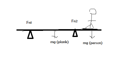

A horizontal, 10-m plank weighs 100 N. It rests on two supports that are placed 1.0 m from each end as shown in the figure. How close to one end can an 800-N person stand without causing the plank to tip?
This is kind of difficult to me, please help me understand this
I know the person weighs 800 and there is X distance
so I have 800N from the weight of the person plus 10 N from the weight of the plank on the right side of the fulcrum
800X + 10 N = 90 N (the weight of the rest of the plank)
Isn't the formula F x Dist so that for this case (800 + 10) * X and the length on the other side would be?
the length of the other side would be 90 meters which equates to 90N
Not good.
On the left we have 90 N * 4.5 m (as we had in October...)
On the right we have
from the person: 800 * (1-X) if X is the distance from the end of the plank
from the plank: 10 N * 0.5 m (Haru's "the rest of the plank")
Now balance the lot and you're done.
