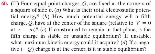

Textbook problem 60 with four equal point charges Q at the corners of a square of side b, asking for total electrostatic potential energy, potential energy of a fifth charge at the center, equilibrium stability, and the effect of a negative charge at the center.

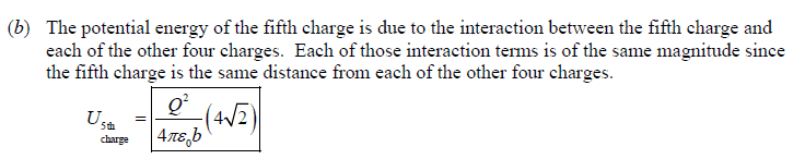

Typed solution for part (b): the fifth charge's potential energy U = (Q^2 / (4 pi eps0 b)) times (4 sqrt 2), with the four pairwise interaction terms said to be equal in magnitude.
The solution guide skipped too many steps. How was this derived? If the 5th charge is in the middle, it will be equidistant (about ##\frac {b\sqrt {2}}{2}##) from each of the other four charges. Did they add up all of the potential energies or do something different? SImply put, I need to see the steps that led to this final answer. Thank you.
They added all the potential energies resulting from the new charge's proximity to the existing four charges. Your distance value is good. So just sum the four contributions.
