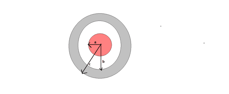

Three concentric spherical metallic shells A , B and C of radii a , b and c (a<b<c)have charge densities σ,−σandσ respectively . If the shells A and C are at the same potential then the relation between a , b and c is
##V##=##\frac{Q}{4πε0r}##
I know the solution
[/B]
but I want to know what does it mean potential of shell A or potential of shell B,I mean what value I shall put in place of r in the formula
##V##=##\frac{Q}{4πε0r}## for shell A,B and C?
Does potential of shell A or potential of shell B etc mean potential at the surface of shell A ,B respectively ?
Yes.
You mislead yourself by coloring in the volume of A and the volume between B and C.
There is no formula ##V = \frac{1}{4πε_0r}##; typo :biggrin: ?
But the r in ##V = \frac{Q}{4πε_0r}## is a for A, b for B and c for C :smile: .
And the potential at a position ##\vec r## is the energy per Coulomb it takes to move a test charge from infinity (Where V = 0) to the position ##\vec r##
Likes gracy

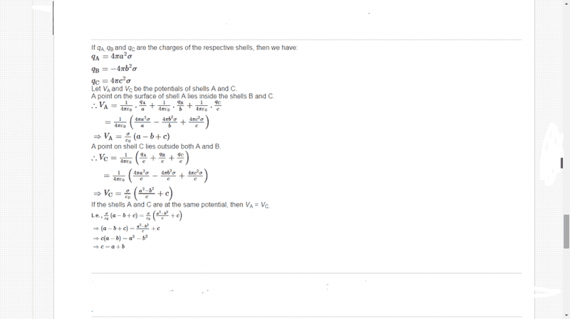

Note that you can't use this for A due to the presence of B and C, nor for B due to the presence of C.
You see that in the solution at the first ##\therefore##
