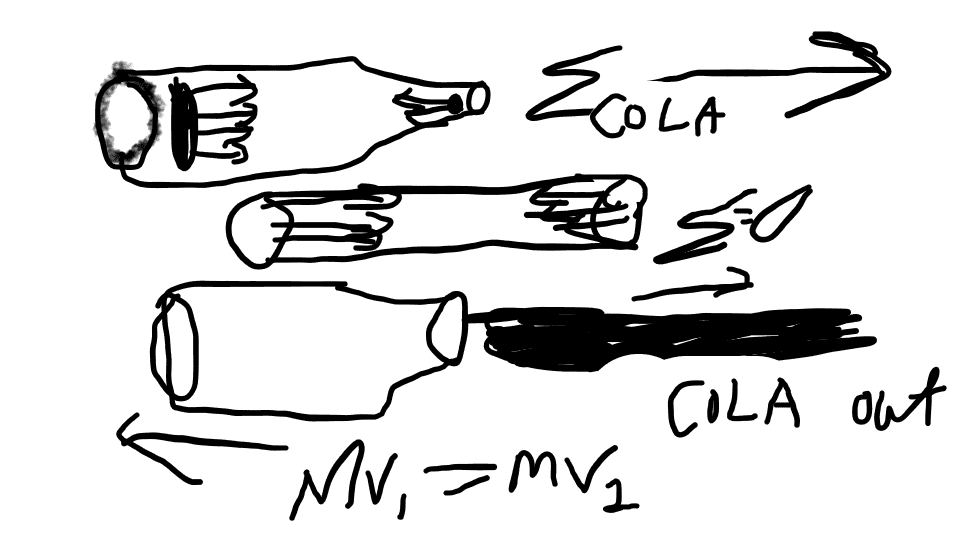

For the bottle going forwards given that it is filled with liquid, I'm concluding that more force is acting towards the lid of the bottle due to the larger surface area at the bottom. As such the water goes forwards. If given a cylinder, nothing would happen.
For the gas and liquid part, the gas "presses" the liquid against the bottom, causing the liquid to exert a force on the bottom, resulting in a reaction force sending the liquid forwards when open?

etotheipi said:
I don't understand what you mean here; what does it mean for the bottle to be 'going forwards'? What is the 'force', of which there is more towards the lid, acting on, and what is its origin? What would change if the bottle is a cylinder?
Arrows on soda are force by bottle.
Their conclusion seems to be based off the soda leaving and the uneven force of the bottle which is in a similar situation as with the soda in the 1st image causing the bottle to go backwards.
For the cylinder scenario, the textbooks theory seems to also work properly.
First bottle is without lid open.
If the lid is open, then the arrows at the top of the bottle are the force due to the atmosphere, on the liquid inside.
If you consider a bottle completely full of liquid, floating in a vacuum (for simplicity), then when you remove the lid the net force on the liquid will be one way and the net force on the bottle the other way, equal and opposite (think conservation of momentum). In the absence of gravitation the pressure in the liquid would be initially uniform (with lid on), so if you remove the lid, the pressure force on the liquid as a whole is now non-zero.
I don't know if that was what you had in mind...?
