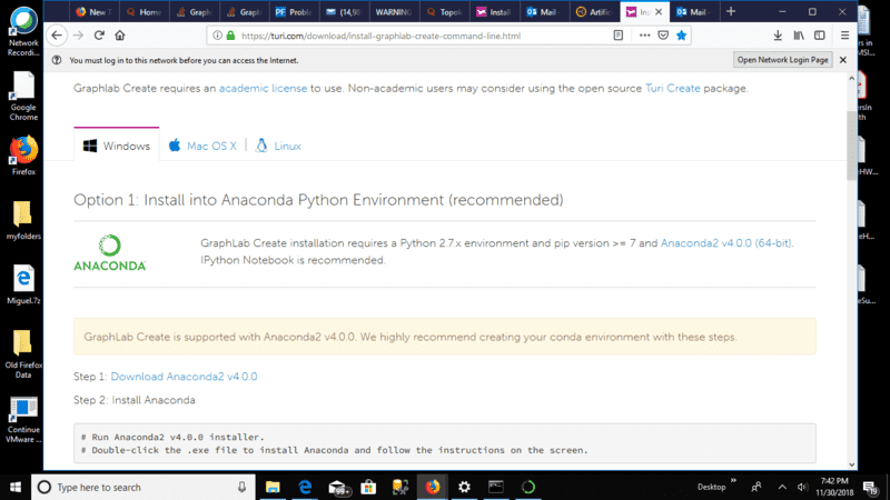

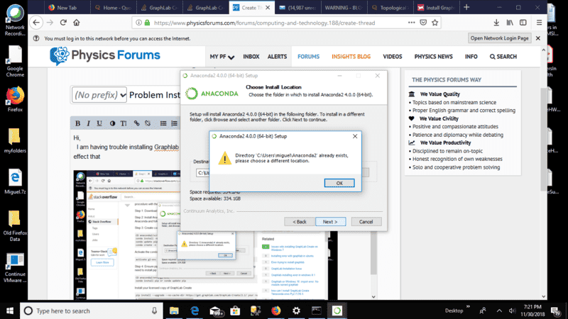

Hi,
I am having trouble installing Graphlab Create from Turi in my Win10. I . First step is to install Anaconda 2.4.0.0 . Everything goes OK, until I need to choose the destination folder. Then I keep getting the same error message to the effect that "Directory x already exists , please choose a different location" . This happens no matter where I choose to save/install
I tried Stack Overflow's recommendation, but it is not working. Anyone, please?

Why are you trying to install such an ancient version? The latest stable version seems to be 5.3.1.
Okay, it seems to be a bug in the installer. The only thing which comes into my mind is that the directory you are trying to install in requires Administrator privileges. However, since I'm not on a Windows, it is difficult to help you more.

Sorry, forgot to update you. I somehow overcame that. Issue now is to activate the Anaconda Environment. My apologies for making you work extra :).
