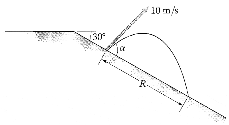

1. A projectile is launched at 10 m/s
from a sloping surface. The angle [tex]\alpha=80 deg[/tex]. Determine the range R.
2. Attached is the drawing.
3. Treat as 2 equations.
x-direction
Initial time t=0 Initial V[tex]_{x}[/tex]=V[tex]_{0}[/tex]Cos[tex]\theta[/tex]
a[tex]_{x}[/tex]dv[tex]_{}x[/tex]/dt = 0
V[tex]_{x}[/tex]=Initial VCos[tex]\theta[/tex] = dx/dt
Integrate and get
x=Initial V(Cos[tex]\theta[/tex])(t)
x=10(Cos80)(t)
Y-direction
a[tex]_{}y[/tex]=-9.81 m/ss
V[tex]_{}y[/tex]=-10Sin80
Im not sure if I am using the correct angle for theta (80 or 50) and I am stuck on the y-direction.
Can you help?
never integrate projectile equations is all that what i will tell ya...
think differently...
What you can try is develop the kinematic equations normal to and along the slope. The accelerations are the components of g in the respective directions. You then set the normal position coordinate to zero as a condition to find the range .
