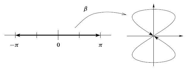

Since from global Frobenius theorem the maximal connected integral submanifolds (leaves) of the foliation are basically immersed submanifolds of the 'ambient' manifold M, I was thinking about the following scenario in ##\mathbb R^2##
The curve above is a Lemniscate and it is an injective immersion of the real line ##\mathbb R## into ##\mathbb R^2## -- note that the curve does not intersect itself at the origin ##(0,0)##.
My point is: we can define of a smooth vector field ##X## on the entire ##\mathbb R^2## such that the (unique) maximal connected integral submanifold passing for ##(0,0)## is the Lemniscate above. Since the global Frobenius theorem guarantees that a foliation of the entire ##\mathbb R^2## does exist, the Leminscate above basically defines 3 regions: the region within the right lobe, the region within the left lobe and the region outside of it.
Hence the maximal connected integral sumbanifolds (i.e. the integral curves) for the points in each of those 3 regions must lie within each of them (i.e. each one cannot extend to points outside of the relevant region).
Does it make sense ? Thank you.
Not sure if this makes sense, but may be I missunderstood you. The curve has two different tangent vectors at the origin, and there is no vector field in the plane that has two values at a point! (The tangent vector field along the curve is not the restriction of a vector field in the plane.)
The curve above is an injective immersion hence only the point ##x=0## of the Real line is mapped to the origin ##(0,0)## of ##\mathbb R^2##. So, I believe, the curve at the origin has only one tangent vector hence it does exist a vector field in the plane that assigns that value at the origin -- i.e. it basically assigns only one vector in the tangent vector space 'attached' at the origin.
@martinbn maybe your concern is about the 'smoothness' of a possibly vector field ##X## in a neighborhood of the origin. In other words, even though the tangent vector is unique at origin, however, there could not exist a smooth vector field ##X## defined on ##\mathbb R^2## such that restricted to the Lemniscate curve gives its tangent vector at each point.
No, here is the standard parametrization (see the wiki page)
##x(t)={a\sqrt{2}\cos t\over 1+\sin^2 t},\quad y(t)={a\sqrt{2}\cos t\sin t\over 1+\sin^2 t},\quad t\in [0, 2\pi]##
For ##t=\frac\pi2## and ##t=\frac{3\pi}2## you get ##(x,y)=(0,0)##.
From the picture it is even obvious, that the curve selfintersect, and is not empbedded in the plane. It is just immersed, but not injectively.
One of the suggested links below leads me to think that you pobably meant this curve?
martinbn said:
One of the suggested links below leads me to think that you probably meant this curve?
Ah yes, you are right.
The above is actually the flipped version of the curve in #20. Here the immersion is ##(-\pi,\pi) \mapsto \mathbb R^2##.
As you can check it is an injective immersion and the tangent vector at the origin ##(0,0)## is unique.
However, as said in #23, does exist a smooth vector field ##X## defined on ##\mathbb R^2## such that its restriction to the above Lemniscate curve gives its tangent vector at each point ?
The Frobenius theorem does not say that any such thing must exist. The Frobenius theorem does not say anything about extending a vector field from some submanifold to the entire manifold--i.e., it does not say that any vector field on a submanifold must be a leaf in a foliation on the entire manifold. It only says that if you already have a smooth vector field on the entire manifold that meets the Frobenius condition, then there will be a corresponding foliation.
Yes, that was actually my point. So we are basically saying that the Leminscate curve cannot be a leaf of a foliation associated with a possible 1-dimensional smooth distribution (i.e. of a smooth vector field ##X## defined on ##\mathbb R^2##).
I don't think so. The value at the origin needs to be the tangent vector to the right sloping part of the curve (the one that contains the point at the origin). On the other hand since it is smooth (or just continuous) it will be the limit of the tangent vectors to the left part of the curve (the one with the arrows). And those are not the same.
It is not a submanifold, so it cannot be an integral manifold of a vector field. On the other hand Frobenius is trivial for 1-dimensional distributions. By trivial I mean that the condition is always true in the 1D case.
