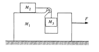

Find the accelaration of ##M_1## in the given system if ##F = 0##.
[/B]

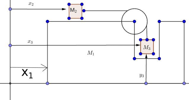

##x_3 -x_1 = k \iff \ddot x_3 = \ddot x_1##
and ##h - y_3 + x_3 - x_2 = l \iff \ddot y_3 + \ddot x_2 = \ddot x_3 \qquad (*)##
h is the height of block ##M_1## and ## l ## is the length of string between ##M_2## and ##M_3##.

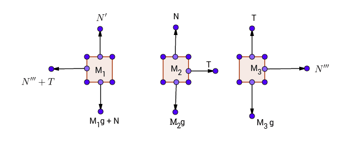

Now from the Free body diagram,
##-M\ddot x_1 = N^{\prime \prime \prime}##
##T = M_2 \ddot x_2##
##N^{\prime \prime \prime} = -M_3\ddot x_3##
##\therefore -M\ddot x_1 = M_2 \ddot x_2 - M_3\ddot x_3 \qquad (1)##

Which is incorrect as the given answer is ##\ddot x_1 = \dfrac{-g(M_2M_3)}{M_1M_2 + M_3M_1 \color{red}{ + 2M_2M_3 +} M_3^2}##.
What is the problem ?
Buffu said:
Now from vertical force on ##M_3##, ##
M_3 - T = -M_3 \ddot y_3##
This equation doesn't look right.
Oh sorry that was a pure typo.
That equation should be,
##M_3g - T = -M\ddot y_3##.
Still not right. On the left side (Fnet) "down" is positive, but on the right side (mass x acceleration) "down" is negative.
Also, check equation (1). The center of mass does not accelerate because the only external force to the three mass system is a vertical force. So ##M_1 \ddot{x}_1+M_2 \ddot{x}_2+M_3 \ddot{x}_3=0##
Likes scottdave
Yes I got the correct answer, but I think ##M_3g - T = -M\ddot y_3## is correct because ## y_3## is pointing upwards and so is ##\ddot y_3## and therefore I put a negative sign, since ##M_3g - T## is downwards as you said. Am I wrong ?
No, it's OK. I fooled myself because I didn't notice ##y_3## in the diagram.
