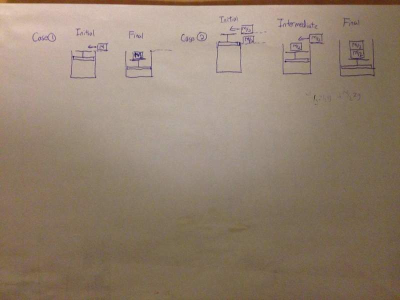

The answers to these questions depend on how we control the motion of the piston. We have total control on the external pressure Pext(t) that we apply and/or the kinematics of the piston motion. Imagine that there is a push-rod attached to the top of the piston, and we control the motion of the rod by hand. When we feel the static friction give way, we can back off on the pressure we apply, so that the piston moves at whatever slow velocity we wish. Or we can try to hold the force we apply constant at the value that existed when the static friction gave way, in which case the gas immediately adjacent to the piston will start to accelerate. We can apply any motion we desire to the piston by controlling Pext(t). When we do this, the non-uniform deformation within the gas will adjust itself in such a manner that σ(I) always satisfies the equation σ(I) + Fkin/A = Pext(t).
Let's say the system is initially at P_o + Fstat/A = Pext and some force is added such that static friction begins to give away to kinetic friction. Assuming that we can back off this force fast enough such that the gas only sees an addition of dP to the external pressure such that now P + Fkin/A = Pext + dP.
1. Can we say at this point that the process so far is quasistatic (P = ideal gas pressure) as we are adding an infinitesimal dP as opposed to an finite Fstat-Fkin which is significant enough for to local pressure increase and viscous stresses?
2. I would assume that regardless of whether the piston is massless or not, at the point in which the gas pressure is P where P + Fkin/A = Pext + dP, the piston probably still be moving. If the piston continues to move, then P + Fkin/A > Pext + dP and the piston would decelerate and push back (if not massless) or just stop (if massless) to maintain force balance. To maintain a positive forward motion without stoppage, the only way I see is to add dP continuously. At the end of the compression, would a massless piston just stop without trouble (and maintain quasistatic) but a piston with mass will now oscillate barring no changes in Pext?

Well, you remember that with a frictionless piston, there can be oscillation. We would have to solve the gas dynamics equations to figure out what is happening after the early part of the deformation, as when, for example, the piston reaches its forward extent for the first time and may want to move backward. The inertia of the gas can also contribute to this picture, since parts of the gas may still be moving when the piston reaches the end of its first stroke.
Yes. However, if the process is quasistatic like this, the viscous stresses in the gas are negligible, and the gas pressure is uniform throughout the cylinder. This is the problem we have have already analyzed.
Yes. That's what we found when we analyzed the problem with friction previously. The gas pressure within the cylinder under these quasistatic conditions will increase, and Pext will have to increase. The gas pressure will be uniform in the cylinder, and the viscous stresses will be negligible.
This question confuses me. If the process is quasistatic, there will be no oscillation. But, Pext will have to increase as the pressure of the gas increases.
In the process I was imagining, if the piston (with mass) is still moving when P + Fkin/A = Pext + dP, any additional motion by the piston would mean that P + Fkin/A > Pext + dP and the piston will decelerate and move backwards where forces are balanced which is not desirable. I thought a solution would be to add dP as soon as the forces balance continuously, which will accelerate the piston by small amounts each time. At the end of the compression, I would still end up with positive momentum for the piston when P + Fkin/A = Pext + ∫dP so if the external forces are maintained constant, I see an oscillation occurring if the piston moves further down (increasing P).
If the piston is massless at the point where P + Fkin/A = Pext + dP, would it stop instantly as the case where P + Fkin/A > Pext + dP is not physically possible?
You are increasing Pext gradually in a quasistatic process. You can do this as slowly as you wish, such that the piston momentum is negligible, even if it has mass. Also, as soon at the piston tries to reverse direction, static friction will kick in again. This whole question is not really a thermodynamics question. It is strictly a mechanics question. I'd like you to try modelling it yourself. Model the gas as a Hooke's law spring with an initial compression. Increase the force Pext a tiny incremental, and see if, with friction, the piston indeed does oscillate.
I don't understand this question. Solving the modeling exercise above will probably answer this question too.
Is the quasistatic nature/viscous stresses affected by the actual speed of the piston or simply how much we are disturbing it from equilibrium? In the scenario I mentioned above I am continuously accelerating the piston so I would get a continuously higher velocities.
Viscous stresses are caused by velocity gradients in the fluid. If there are no significant velocity gradients, then the viscous stresses are negligible. The absolute magnitude of the deformation is not important (as far as viscous stresses are concerned). If you want to get an idea of how viscous stresses come into play, include a damping element in parallel with the spring in the model I discussed above.

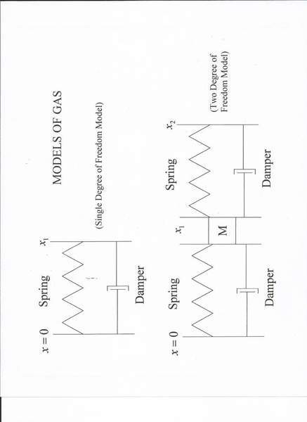

In this response, I will be referring to the attachment below:
https://www.physicsforums.com/attachment.php?attachmentid=70091&stc=1&d=1401192844
Red_CCF said:
In the situation I was thinking, the piston wouldn't be stopping and going at every dP addition. I was trying to avoid the constant back and forth switch between kinetic and static friction, which means that the piston is constantly accelerating up to the end of the compression. The force balance I came up with was:
APext + AdP + mg - k|(x-x0)| - Fkin = ma
I am not sure if the above is correct or how I would solve this to get the velocity at the end of the compression.
In the attachment, I have included two "models" of the gas behavior to help is quantify our discussion. The first model has one degree of freedom, and features a spring in parallel with a damper (the combination is commonly referred to as a Voigt element). The spring simulates the local p-v-t behavior of the gas, and the damper simulates the viscous dissipation. The parameter x1 represents the displacement of the piston.
The second model has two Voigt elements, with a mass in-between (simulating the mass of the gas). This model has two degrees of freedom. In this lumped model, x2 represents the displacement of the piston, and x1 represents the displacement half-way through the gas. The stiffness of the springs and the damper constants in this model are not the same as for the single degree of freedom model, but are appropriately adjusted to give equivalent behavior.
In my responses in this posting, we will be focusing exclusively on the first model. Later we can get to the second model, if necessary.
For the single degree of freedom model, the force balance just before static friction releases would read :
APext+ mg + kx10 - Fstat = 0
where x10 is negative to represent initial compression of the gas.
I'm going to stop here for now, and give you a chance to digest the gas models, and ask questions.
Chet

Is there a reason why we are adding a damper? If we assume that there is always a dP difference between Pext and Friction + PI (the system is able to pull back force once static gives away to kinetic friction), the process should be quasistatic so would the "damping" effect from viscous stresses would be zero and are we just doing a general case where we can set the damping to coefficient to zero for the quasistatic model?
If the piston was massless, can we just set m = 0 of the general solution or does it affect the fundamental setup in some way?

Continuing the analysis, the force balance on the piston after static friction releases is given by:
[tex]AP_{ext}(t)+mg-F_{kin}+\left(kx_1+C\frac{dx_1}{dt}\right)=-m\frac{d^2x_1}{dt^2}[/tex]
where C is the (viscous) damping constant and where the piston displacement x1 is measured upward (so, for compression, x1 is negative).
If we subtract the force balance equation just before static friction releases from this equation, we obtain:
[tex]AΔP_{ext}(t)+(F_{stat}-F_{kin})+\left(kΔx_1+C\frac{d(Δx_1)}{dt}\right)=-m\frac{d^2(Δx_1)}{dt^2}[/tex]
where [itex]ΔP_{ext}=P_{ext}-P_{ext,static}[/itex] and [itex]Δx_1=x_1-x_{10}[/itex].
Is this formulation acceptable to you so far?
Chet
Chet

Chet
[tex]\frac{d(Δx_1)}{dt}+\frac{k}{C}Δx_1= -\frac{A}{C}ΔP_{ext}(t)-\frac{1}{C}(F_{stat}-F_{kin})[/tex]
[tex]Δx_1 = -\frac{1}{e^\frac{kt}{C}}∫e^\frac{kt}{C}\frac{A}{C}ΔPext(t)dt - \frac{Fstat - Fkin}{k}+\frac{CONST}{e^\frac{kt}{C}}[/tex]
I imagine that Pext(t) is the forcing function and its properties be known. I am unsure how to evaluate the arbitrary constant without knowledge of the first integral though.
I'm also wondering, what is the difference between the equation with and without Δ?
Thanks
In the description of Case 2, what do the words "Pext does not change" mean to you with regard to ΔPext? This should give you enough information to determine CONST.
It just seems easier to me to work in terms of the equation with the Δ's; it eliminates the x0 and the mg. Mathematically, of course, there's no difference.
Chet

If ΔPext(0) = 0 and Δx1(t) = 0
[tex]CONST = e^\frac{kt}{C}(\frac{Fstat - Fkin}{k})[/tex] and
[tex]Δx_1 = -\frac{1}{e^\frac{kt}{C}}∫e^\frac{kt}{C}\frac{A}{C}ΔPext(t)dt[/tex]
Thank you
  • #79
Red_CCF said:
What I am confused by is, why are pure species treated differently than compounds when setting s = 0 in reference state? How come I can't subtract off, from the absolute entropy at some T and p, a substances' entropy at its reference state such that any substance has zero entropy at its reference state, which I am imagining as a "origin/zero point"?
If we take S = 0 for the pure elements in the reference state, then the entropy of the compound formed from these elements at the reference temperature and pressure can't be zero. Let's consider your specific example:
State A: 1/2 mole of pure oxygen(g) and 1 mole of pure hydrogen(g) (in separate containers) each at the reference temperature and pressure.
State B: 1 mole of pure liquid water at the reference temperature and pressure (in a third container).
The change in entropy for a process that goes from State A to State B is not equal to zero. The "entropy of formation" of liquid water at the reference temperature and pressure is defined as the change in entropy ΔS for this specific process.
Now, the real challenge is to dream up a reversible process that goes from State A to State B (so that the change in entropy can be measured). Can you think of such a process? It might help to think in terms of a vant Hoff equilibrium box, and semipermeable membranes.
I was thinking in terms of the force balance for the quasistatic case at the instant that friction switches from static to kinetic. In such a case, would Pext(t = 0+) = Pext, static - (Fstatic/A - Fkinetic/A - dP)? This would result in Pext(t = 0+)A + mg - PIA - Fkinetic = dP = ma.
Sorry. I still don't follow. Is dP supposed to be the change in pressure of the gas, or is it supposed to represent a slight incremental increase in the external pressure?
Case 2 states that "Pext does not change" means that ΔPext is not just zero at time t = 0. It means that ΔPext is held equal to zero for all times. In other words, Pext is held constant throughout the deformation at its (high) value that existed just before static friction released. So:
[tex]Δx_1 = -\frac{(F_{stat} - F_{kin})}{k}\left(1-e^{-\frac{kt}{C}}\right)[/tex]
This is how the piston has to be moved to keep Pext constant at its value that existed just before static friction released.
Chet

Hi. It finally dawned on me what you are asking here. For this case,
[tex]P_{ext}(t)=P_{ext,static}-\frac{(F_{static}-F_{kinetic})}{A}+δP_{ext}(t)[/tex]
This is the same as:
[tex]ΔP_{ext}(t)=-\frac{(F_{static}-F_{kinetic})}{A}+δP_{ext}(t)[/tex]
If we substitute this into our differential equation, we obtain:
[tex]AδP_{ext}(t)=-kΔx_1-C\frac{dΔx_1}{dt}-m\frac{d^2Δx_1}{dt^2}[/tex]
Now, let's suppose that we force the piston to undergo a very small constant acceleration of a. The question is, in what way would δP have to be varied as a function of time to accomplish this? With constant acceleration, we would have
[tex]Δx_1=\frac{1}{2}at^2[/tex]
and
[tex]t=\sqrt{\frac{2Δx_1}{a}}[/tex]
If we substitute these relationships into the differential equation, we obtain:
[tex]AδP_{ext}(t)=-(kΔx_1+C\sqrt{2aΔx_1}+ma)[/tex]
Now, if the acceleration is very small, but we wait a very long time for the displacement to reach a desired value of Δx1, this equation reduces to:
[tex]AδP_{ext}(t)=-kΔx_1[/tex]
Do you see that, in this quasistatic case, the acceleration term and the viscous dissipation term become negligible?
Chet

Here is a summary so far for the piston motion:
1. No viscous dissipation, no piston mass, no gas mass: Δx1=ΔF/k
2. With viscous dissipation, no piston mass, no gas mass: [itex]Δx_1=\frac{ΔF}{k}(1-e^{-\frac{kt}{C}})[/itex]
(Note that, in this situation, the piston does not oscillate.)
Chet
For the case with mass, the ODE becomes:
[tex]m\frac{d^2(Δx_1)}{dt^2}+C\frac{d(Δx_1)}{dt}+kΔx_1=(F_{kin}-F_{stat})[/tex]
The solution will depend on the actual values of m,C, and k
[tex]r = \frac{-C\pm\sqrt{C^2-4mk}}{2m}[/tex]
assuming that the roots are real the homogeneous solution would be
[tex]Δx_1 = c_1e^{\frac{-C+\sqrt{C^2-4mk}}{2m}t} + c_2e^{\frac{-C-\sqrt{C^2-4mk}}{2m}t}+(F_{kin}-F_{stat})/k[/tex]
if the roots are imaginary, the homogeneous solution would be
[tex]Δx_1 = e^{\frac{-C}{2m}t}(c_1sin(\frac{\sqrt{4mk-C^2}}{2m}) + c_2cos(\frac{\sqrt{4mk-C^2}}{2m})+(F_{kin}-F_{stat})/k[/tex]
which gives a decaying oscillation. I assume that the first peak would take the piston past equilibrium BDC and as t -> ∞ we converge at the actual BDC which happen to be (F_kin-F_stat)/k.
Thanks very much
  • #84
and
Chet
Is there a reason why δP is used here instead of dP?
I've always thought that an infinitessimal quantity is already the smallest possible unit (and essentially a "constant"), but here we have to vary this to maintain a certain acceleration small enough for the approximation to hold. Are we allowed to vary this (and to what degree) and still call it an infintessimal disturbance as it appears that δP increases with time as Δx increases with time?
Thanks very much
Yes. This is correct. Now, before we talk about the cases where the mass is large enough for the roots to be imaginary, let's talk a little more about the case of real roots. I would like to re-express the roots in a slightly different form:
[tex]r_1 = \frac{-C+\sqrt{C^2-4mk}}{2m}=\frac{-2k}{C+\sqrt{C^2-4mk}}=\frac{-2k/C}{1+\sqrt{1+\left(\frac{4mk}{C^2}\right)}}[/tex]
[tex]r_2 = \frac{-C-\sqrt{C^2-4mk}}{2m}=\frac{-2k}{C-\sqrt{C^2-4mk}}=\frac{-2k/C}{1-\sqrt{1-\left(\frac{4mk}{C^2}\right)}}[/tex]
For small values of the piston mass m, do you know how to linearize these roots with respect to ##\frac{4mk}{C^2}##? If so, please do. Also, from the initial conditions, do you know how to determine the constants of integration c1 and c2? If so, please do.
Chet

From assuming Δx = 0 and d(Δx)/dt = 0 at t = 0, for the constants I got:
[tex]c_1 = \frac{(F_{kin} - F_{stat})(1-\sqrt{1-\frac{4mk}{C^2}})}{2k\sqrt{1+\frac{4mk}{C^2}}}[/tex]
[tex]c_2 = \frac{(F_{stat} - F_{kin})(1+\sqrt{1+\frac{4mk}{C^2}})}{2k\sqrt{1+\frac{4mk}{C^2}}}[/tex]
I'm not sure if I'm doing this correctly, but the square root would be linearized, for [itex]f(x) = \sqrt{1\pm x}[/itex] :
[itex]L_1(x) = \sqrt{1-\frac{4mk}{C^2}} - 1/2(x-\frac{4mk}{C^2})(1-\frac{4mk}{C^2})^{-0.5} for \sqrt{1-\frac{4mk}{C^2}}[/itex]
and
[itex]L_2(x) = \sqrt{1+\frac{4mk}{C^2}} + 1/2(x-\frac{4mk}{C^2})(1+\frac{4mk}{C^2})^{-0.5} for \sqrt{1+\frac{4mk}{C^2}}[/itex]

To maintain a small but constant acceleration, are we basically applying δP (via series of dP) to let the piston accelerate initially and wait for the piston to decelerate by a certain extent before applying δP again?
No. δP is a function of time. It is the time-dependent pressure variation we need to apply over the entire deformation to hold the acceleration constant at a very small value. When we reach the desired final deformation, we stop increasing δP and, since it then only results in a negligible net load on the piston, the deformation ceases.
[tex]AδP=\left(\frac{1}{2}at^2\right)k+(at)C+ma[/tex]
where a is the downward acceleration.
Chet
