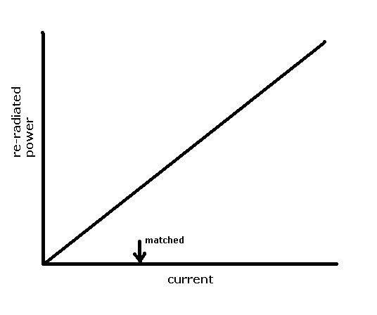

I believe the question right now is whether a properly terminated dipole will reradiate anything at all.
I suspect that it will. If the dipole current is allowed to flow at all, then the dipole will still radiate. Like this:
The ultimate case would be two unconnected quarter wave lengths with no current flowing between them. I wouldn't expect this to radiate at all.

  • #35
I don't know where you got your graph from, but the re-radiated power should be quadratic with the antenna current, not linear.
