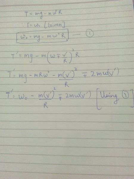

A body is suspended on a spring balance in a ship sailing along the equator with a speed ## v' ## . If ## \omega ## is the angular speed of the Earth and ## \omega_0 ## is the scale reading when the ship is at rest , the scale reading when the ship is sailing, will be very close to
(a) ## \omega_0 ##
(b) ## (\omega_0)(1 + \frac { 2 \omega v'}{g}) ##
(c) ## (\omega_0)(1 \mp \frac { 2 \omega v'}{g}) ##
(d)none of these
Let mass of object be m
Radius of Earth be R.
Tension in spring balance=Reading in spring balance = ## \omega_0 ##
Tension be T when ship not sailing and Tension be T' when ship is sailing
When ship is not sailing
## mg - T = m (\omega)^2 R ##
When ship is sailing
## mg - T' = m (\omega \mp v'/R)^2 R ##
I solved for T' but the answer is not coming.
I could show the working but latex is hard to write.
But if you don't post your working nobody can tell where you are going wrong.
That's fine so far, but notice that in the answers everything is expressed as a multiple of ##\omega_0##. Get your answer into that form. (You will probably also need to discard some third order term.)
Likes AakashPandita
Wait a minute. Doesn't the value of g that we use account for the centripetal force due to rotation of earth? Is ## g- (\omega)^2 R =g ## using approximation? If yes then how?
I got the answer. Thanks a lot.
