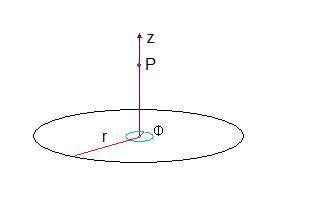

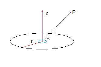

Is this the right diagram:
I think it should be the second one, since you stated:
draw a picture, and try to express this in terms of cylyndrical coordinates and unit vectors...remember, since you are trying to find the field at "a distance Z on the axis of the circular loop", your point P is at [tex](r, \phi, z)=(0,0,Z)[/tex]

  • Diagram of a circular loop lying flat in a plane, with a vertical z axis through its center, a radius r marked from the center to the rim, and a point P above the plane with a line from the center to P labelled phi.

  • Diagram of a circular loop lying flat in a horizontal plane, with a vertical z-axis through its centre, a point P on the axis above the loop, and a red radius r drawn from the centre to the rim.

The second one is close, but you have mislabeled 'r'...the radius of the circular path of the wire is capital 'R', little 'r' should represent the distance form P to an infinitesimal length of the wire dl...you should shade in a short section of the wire and call it 'dl'...then find an expression for the vector from 'dl' to 'P'...

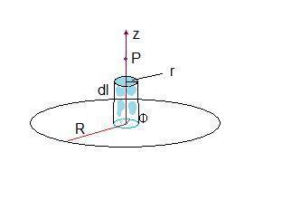

Okay so firstlty I have the midifed attached image (Its a JPEG, hence the reason the filling in is poor)
so I need an expression for the vector from dl to P. would it not be [tex]\hat{z}[/tex], since the point P is on the Z axis, and so the vector would go from the centre of the loop to P, which is just up along the Z-Axis

  • Diagram of a circular loop of radius R lying in a horizontal plane, with a small line element dl at angle phi on the loop, a vertical z axis through the centre, and a point P on the z axis above the loop.

P is on the z-axis, but dl is not!...So how could the vector [itex]\hat{z}[/itex] possibly go from dl to P?
dl is an infinitesimal length of the wire...where is the wire? Pick a tiny section of the wire and call it dl...what are it's coordinates?
wire of radius R lies in the xy-plane and is centred at the origin.
I see now, the wire is a loop around the x-axis, not up down it. so a point on the z axis would be [tex]R^2 + Z^2 [\tex] from the wire?<br /> <br /> TFM[/tex]
[tex]\sqrt{R^2+Z^2}[/tex] gives you the length of the vector [itex]\vec{r}[/itex], but you also need to know its direction...draw an arrow from dl to P...which way does it point?
Its pointing towards the Z-axis, but at an angle towards it, not parallel
TFM
Okay, call that angle [itex]\alpha[/itex]; then the direction of [itex]\vec{r}[/itex] is [itex]-\cos \alpha \hat{r}+\sin \alpha \hat{z}[/itex] Is it not?...now look at the triangle, what are [itex]\cos \alpha[/itex] and [itex]\sin \alpha[/itex] in terms of R and Z?
[tex]cos \alpha =\frac{Adjacent}{Hypotenuse}[/tex]
[tex]sin \alpha =\frac{Opposite}{Hypotenuse}[/tex]
Hypotenuse will be the lkine from I to P, and the adjacent will be R, opposite will be Z
TFM
Yes, but isn't the length of the line from dl to P [itex]\sqrt{Z^2+R^2}[/itex]?...what does that give you for [itex]\vec{r}[/itex]?
