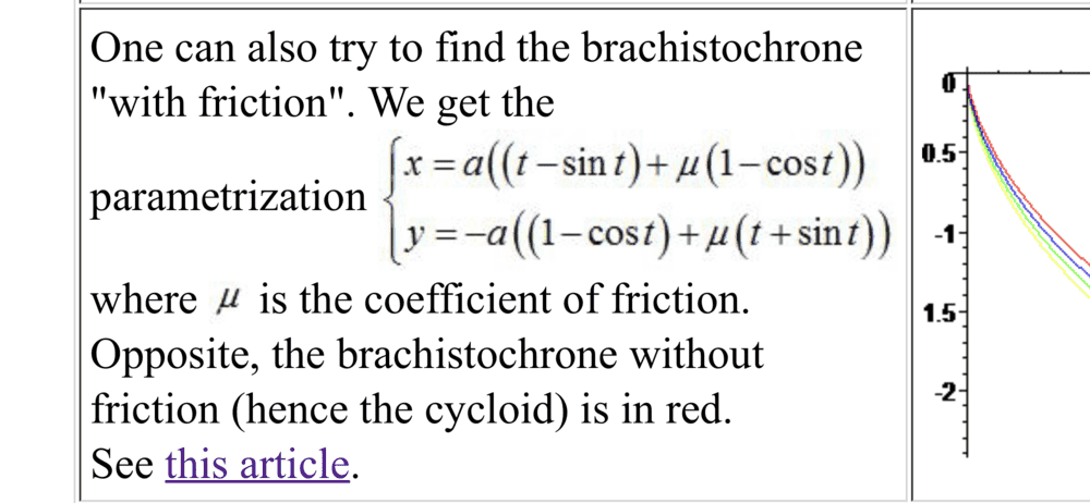

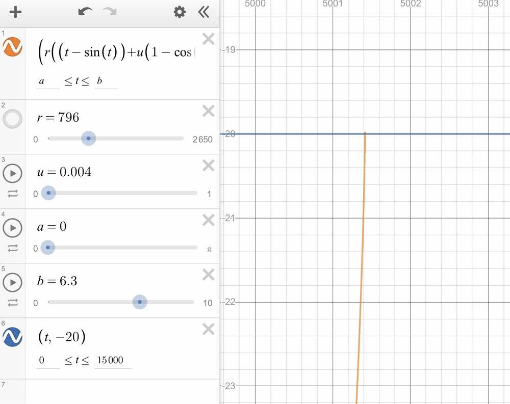

Would it be possible to find t and r via the exact same equations as found in posts #4 and #10, and then find the parametric curve by incorporating the coefficient of friction via (where r is labeled a):
from:
https://mathcurve.com/courbes2d.gb/brachistochrone/brachistochrone.shtml

This was already explained in the linked article. To summarise, imagine the particle as bead sliding along a rail in the shape of the trajectory. The contact force ##\mathbf{N}## satisfies$$(\mathbf{N} + m\mathbf{g})\cdot \mathbf{n} = \frac{mv^2}{\rho} \mathbf{n}$$If you approximate the RHS to be negligible, then$$\mathbf{F}_{f} = -\mu N \mathbf{t} = -\mu mg\cos{(\theta)} \mathbf{t}$$Apply Newton II tangentially,$$-mg\sin{(\theta)} - \mu mg \cos{(\theta)} = m\ddot{s}$$But ##\cos{(\theta)} = dx/ds## and ##\sin{(\theta)} = dy/ds##, so$$-g \frac{dy}{ds} - \mu g \frac{dx}{ds} = \ddot{s} = \dot{v}$$Now, critical step is to rewrite$$\dot{v} = \frac{dv}{ds} \frac{ds}{dt} = v\frac{dv}{ds} = \frac{1}{2} \frac{d}{ds} \left( v^2 \right)$$so that$$-2g \frac{dy}{ds} - 2\mu g \frac{dx}{ds} = \frac{d(v^2)}{ds}$$and now integrate, taking ##v(0,0) = 0##,$$-2g(y + \mu x) = v^2 \implies v = \sqrt{-2g(y+\mu x)}$$Now we can define the time functional$$T[y] = \int_0^l \frac{ds}{v} = \int_{x_0}^{x_1} \frac{\sqrt{1+y'^2}}{\sqrt{-2g(y+\mu x)}} dx$$Now you can let$$\mathcal{L} = \frac{\sqrt{1+y'^2}}{\sqrt{-2g(y+\mu x)}}$$and we now have to compute ##\mathcal{L}_{y}## and ##\mathcal{L}_{y'}##, and use the Euler-Lagrange condition for extremum ##\mathcal{L}_{y} = \frac{d}{dx} {\mathcal{L}}_{y'}##, i.e.$$\frac{g\sqrt{1+(y')^2}}{(-2g(y+\mu x))^{\frac{3}{2}}} = \frac{d}{dx} \left( \frac{y'}{\sqrt{(1+y'^2)} \sqrt{-2g(y+\mu x)}} \right)$$ $$\frac{g\sqrt{1+(y')^2}}{(-2g(y+\mu x))^{\frac{3}{2}}} =
\frac{
\sqrt{1+(y')^2} \sqrt{-2g(y+\mu x)} y'' - y' \left( y' y''\frac{\sqrt{-2g(y+\mu x)}}{\sqrt{1+(y')^2}} - g(y' + \mu)\frac{\sqrt{1+(y')^2}}{\sqrt{-2g(y+\mu x)}} \right)
(1+y'^2)(-2g(y + \mu x))
$$Now we must find a substitution to make this equation more manageable!
Likes Devin-M
You can actually simplify it fairly nicely, first multiply through by ##(-2g(y+\mu x))^{\frac{3}{2}}(1+y'^2)^{\frac{3}{2}}##, and you get$$g(1+y'^2)^2 = y''(1+y'^2)(-2g(y+\mu x)) - y'^2 y''(-2g(y+ \mu x)) - gy'(y' + \mu)(1+y'^2)$$Now regroup the ##y''## terms,$$\begin{align*}g(1+y'^2)^2 &= y'' \left[ (1+y'^2)(-2g(y+\mu x)) - y'^2(-2g(y+\mu x)\right] - gy'(y' + \mu)(1+y'^2) \\ &= -2gy''(y+\mu x) - gy'(y' + \mu)(1+y'^2)\end{align*}$$And finally transpose the second term$$g(1+y'^2) \left[ 1+2y'^2 + \mu y' \right] + 2gy''(y+\mu x) = 0$$

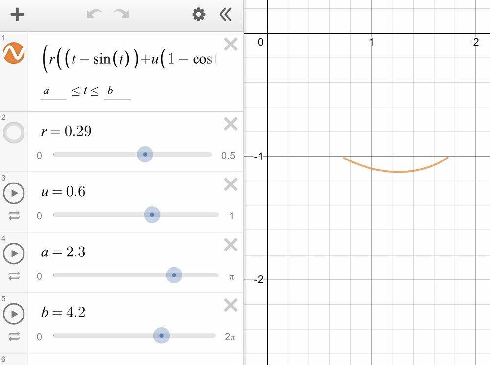

I haven’t yet managed to rearrange the formula to solve for r, ta, tb, u but just wanted to find an initial very approximate solution as a guide.
My goal was to find a curve with an approximate initial depth of -1, a horizontal distance of 1 and a nonzero u and after fiddling around for a while I got this:
https://www.desmos.com/calculator/gquh3kpggq

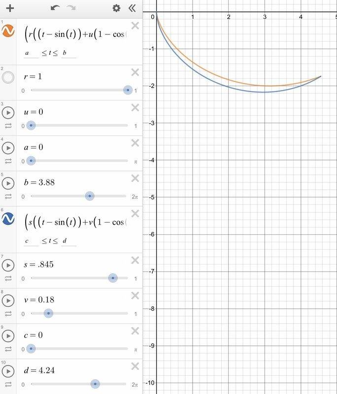

I’ve been able to approximate the results in the linked article:
Parametric Graph: https://www.desmos.com/calculator/jkth1kofbd
Starting with a cycloid radius 1 with a final angle of 3.88 rad with 0 friction coefficient, I increased the friction coefficient to 0.18 and concluded it is necessary to reduce the radius from 1 to 0.845 and increase the final angle from 3.88 rad to 4.24 rad to reach approximately the same endpoint in the shortest possible time. With the added friction, the optimal path “goes deeper” than the frictionless path.
Likes etotheipi

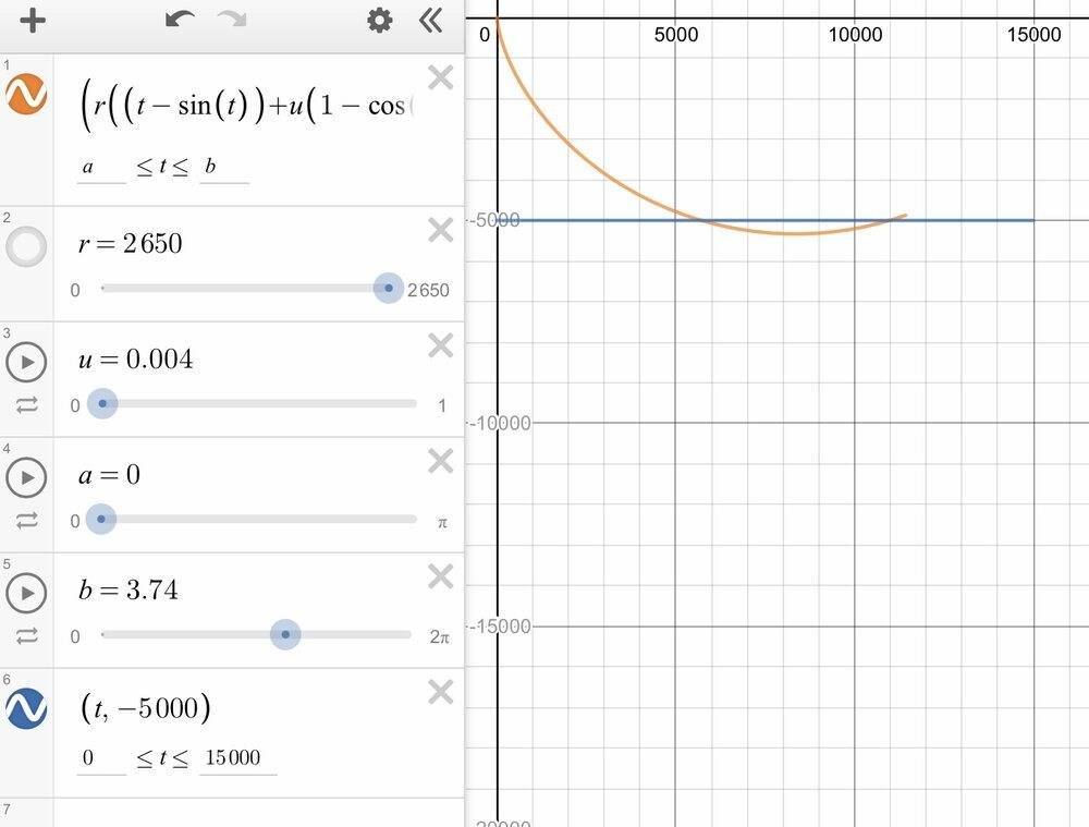

The best I can do at this point is say here is the quickest, traversable path between horizontal points with an initial velocity and a 250:1 lift to drag ratio (0.004 coefficient of friction), but I don’t know the initial velocity or the exact horizontal distance. The start and endpoints are at the 2 intersections of the orange and blue lines (the test body starts at rest from the origin and crosses the blue line with an initial velocity and crosses again with a final velocity):
Parametric Graph: https://www.desmos.com/calculator/peb5xdtqgk
Ideally I would like to find the minimum initial velocity for the optimal (for time) traversable pathway with a given horizontal distance, local gravity and coefficient of friction.

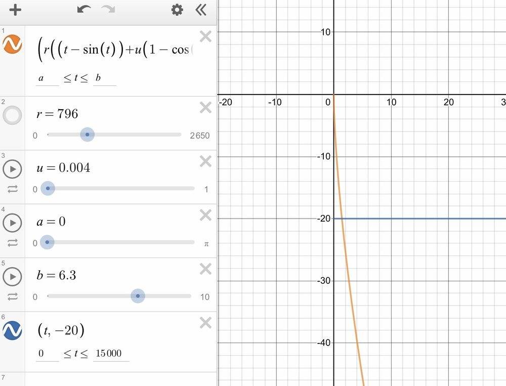

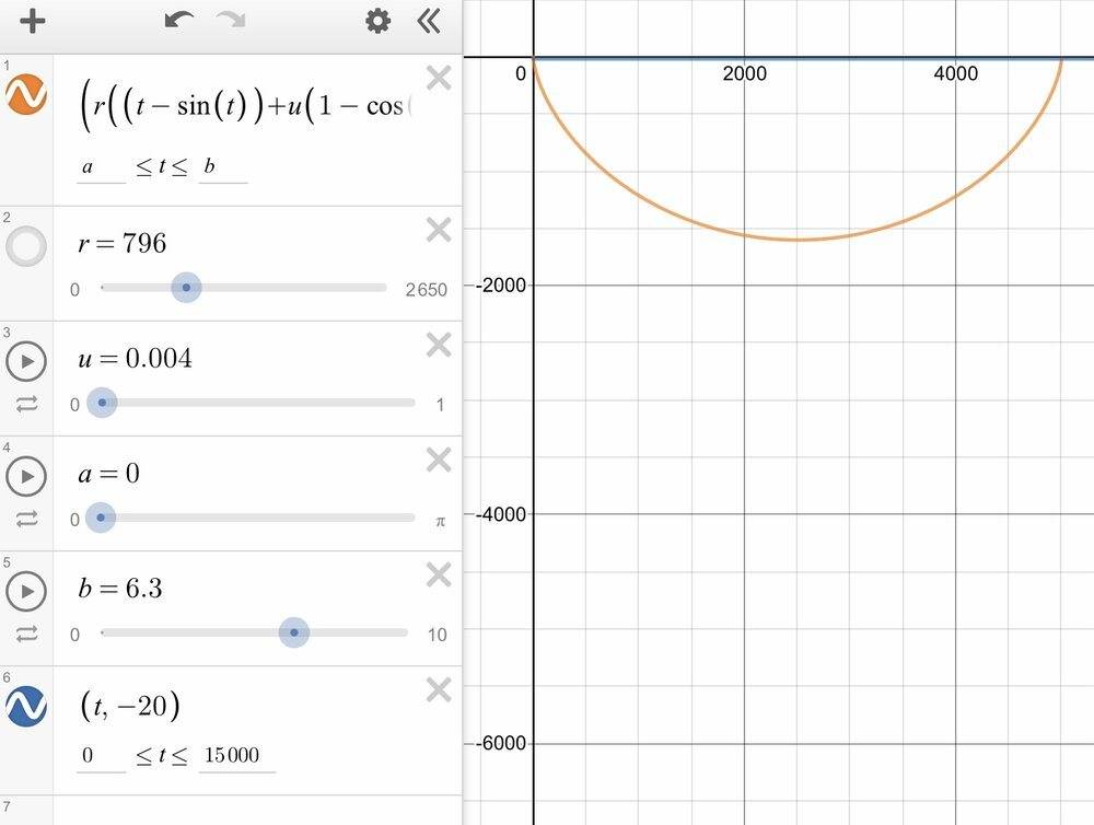

Playing around with the graph a bit more I find the minimum initial velocity for a horizontal distance of 5000m with 250:1 lift to drag ratio is equivalent to a fall down the ramp from the origin of roughly 20 meters and the optimal path for time for such a vehicle is very close to a cycloid. This gives a very rough minimum initial velocity of 19-20m/s in 9.8m/s^2 gravity or roughly ~43mph.
Graph: https://www.desmos.com/calculator/fxu9dcvmps
With a given r and u, is it possible to determine the y position of the cusp on the right hand side, use that to determine the initial velocity at the same depth from the cusp at the origin on the left hand side, and use that to calculate the travel time with minimal initial velocity?
