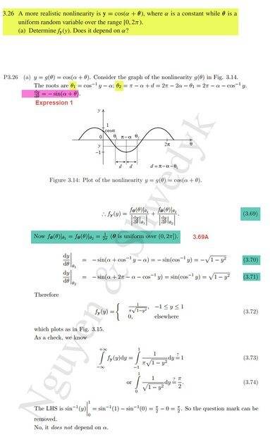

Hi,
I was trying to solve the attached problem which shows its solution as well. I cannot understand how and where they are getting the equations 3.69 and 3.69A from.
Are they substituting the values of θ₁ and θ₂ into Expression 1 after performing the differentiation to get equations 3.70 and 3.71?
As you can see that the solution is there but I need to understand it. I'd really appreciate if you could help me with it. Thank you!
Hi-resolution image copy: https://imagizer.imageshack.com/img923/1491/lXm2aZ.jpg

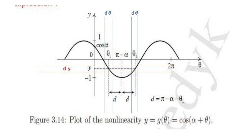

Thanks. So I observe correspondence of areas for distribution of y and ##\theta## as attached.

My apologies but I still don't get how and where they are getting the equations 3.69 and 3.69A from.
[tex]f_y(y)dy = f_\theta(\theta) d\theta|_{\theta_1}+f_\theta(\theta) d\theta|_{\theta_2}[/tex] or more strictly on sign
[tex]f_y(y)|dy| = f_\theta(\theta) |d\theta||_{\theta_1}+f_\theta(\theta) |d\theta||_{\theta_2}[/tex]
Divide the both sides by |dy|.
What is [itex]f_\theta(\theta) d\theta[/itex] and where does this come from? I don't see its connection with the original function y=cos(α+θ). Could you please help?
[tex]f_\theta(\theta)\ d\theta|_{\theta_1}[/tex]
is probability of ##\theta## to take value ## [\ \theta_1-\frac{1}{2} d\theta,\ \theta_1+ \frac{1}{2}d\theta\ ]##
It comes from the graph of y-##\theta## correspondence as I have attached.

If you have a random variable ##X##, you can have a function of that variable ##g(X)## which defines a new random variable ##Y=g(X)##. ##X## has a pdf ##f_X(x)##; similarly, the variable ##Y## has a pdf ##f_Y(y)##.
Assume for a moment that ##g(x)## monotonically increases. The function ##g## maps the interval ##(x,x+dx)## to the interval ##(y,y+dy)##, so the probability that ##X## is between ##x## and ##x+dx## should be equal to the probability ##Y## is between ##y## and ##y+dy##. In terms of the pdfs, you have
$$f_X(x)\,dx = f_Y(y)\,dy.$$ Since ##dy = g'(x)\,dx##, you get ##f_Y(y) = f_X(x)/g'(x)##.
If ##g## were a decreasing function, however, we'd run into a problem as the pdfs need to be non-negative. In that case, we should have ##f_Y(y) = -f_X(x)/g'(x)## instead. To cover both cases, we use the absolute value of ##g'(x)##.
Finally, if we drop the requirement that ##g## is a one-to-one function, then it's possible that more than one value of ##x## maps to a particular value of ##y##. In that case, we need to sum the probabilities to get
$$f_Y(y)\,dy = \sum_{g(x_i)=y} f_X(x_i)\,dx \quad \Rightarrow \quad f_Y(y) = \sum_{g(x_i)=y} \frac{f_X(x_i)}{\lvert g'(x_i) \rvert}.$$ This formula applied to this particular problem is where equation 3.69 comes from.
